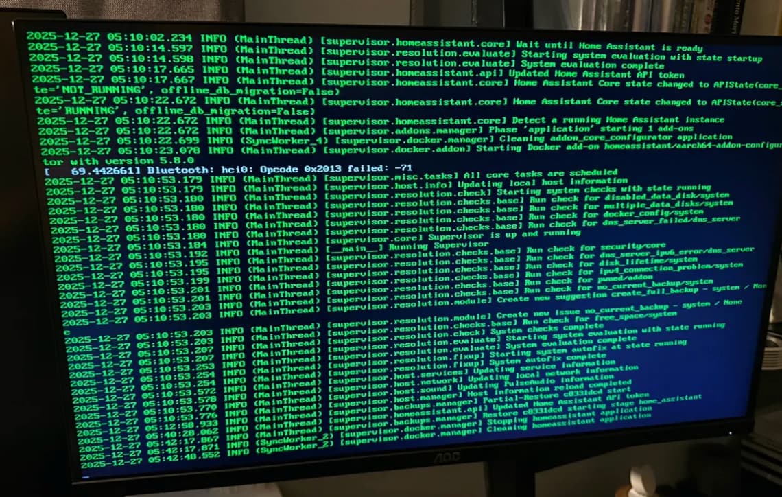

My backup is large 28GB+. I’ve tried restoring this on both the original rasberry pi with SSD attached which it came from as well as a VM running home assistant OS on a dedicated NUC server. Both land stuck on the below screen.

If you can access the Home Assistant CLI while it seems to hang (e.g. by attaching a keyboard and monitor, or ssh) in the CLI try typing: jobs info
It gives you running jobs. If you see an empty list, it is not doing anything. If it is busy, you see what jobs it finished and which are running (such as restore parts of HA or addons)
ps. I’m about to do some training, so I may not respond for an hour or so).
@Edwin_D no worries, thanks! Yes i can access cli via keyboard and monitor. I have run the jobs info command and when I thought it was hung I did see jobs. Is there any way to get more details on where those jobs are? How long should those jobs take?
They should show which ones are waiting and which are running. I could follow progress quite ok back when I restored.
A couple hours on my longest one never waited more than 3.
