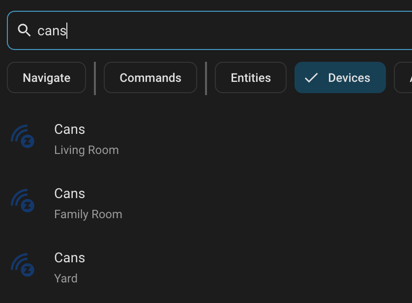

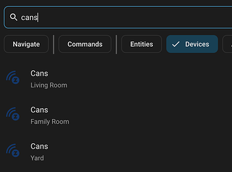

For some reason I call my recessed lights “cans”:
And in this case Alexa just turns on one of them, regardless of what room I’m in, and Google Assistant punts and turns on all of them. :wink:

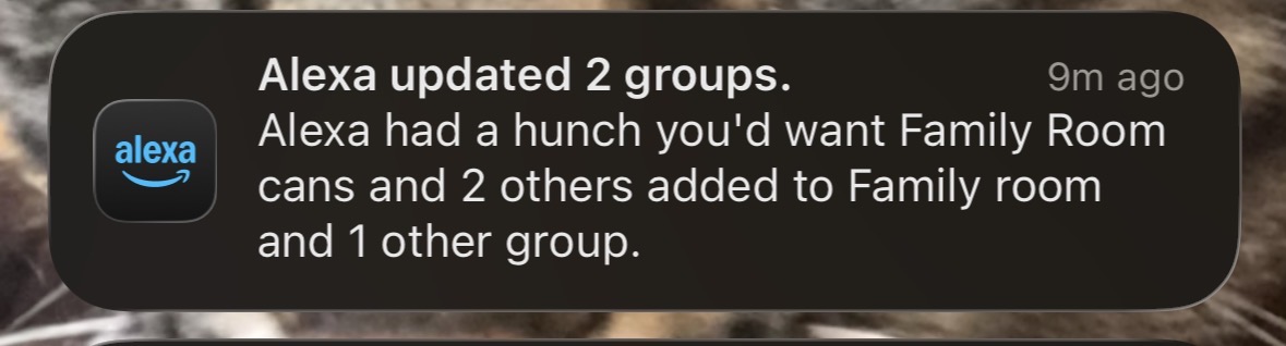

When I renamed them back to “Living Room cans” I got this. So, it tries based on the name – so an argument for keeping the area in the name, perhaps…
I’d turn off hunches, otherwise your lights will randomly start to turn on/off.
