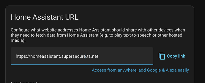

I set up remote access using this Tailscale/Funnels guide:
I also set URL in HA:
URL
For testing, I tried TTS service to cast to my chromecast, but for some reason it doesn’t pick up the remote URL:

What I am doing wrong here?
I have local network and internet? Which did you configure?
What ip address does that domain name resolve to?
It appears you have set the internal_url option to http://192.168.1.26:8123, which is the IP address of HA plus the port 8123 (the port HA UI is served from). Reading the docs, it seems you are supposed to only set the IP address of HA without the port.
The docs say if you set an internal_url all communication remains inside your home network. Funnel isn’t involved here.
Can you try setting internal_url option to http://192.168.1.26?
