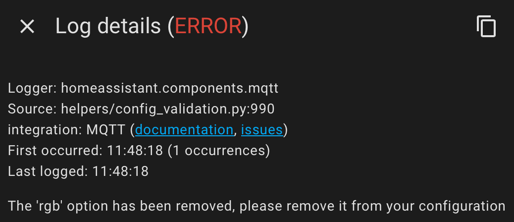

The 'rgb' option has been removed, please remove it from your configuration
Unfortunately Home Assistant never specifies the associated config if there is an error. Just check “your” config. The “details” are not saying anything either…very annoying!
Now I get this error:
I can’t find any config where that option is in. My mqtt.yaml is almost empty and does not have anything with rgb in it. Neither my config.yaml.
How do I find the file this error is related to???

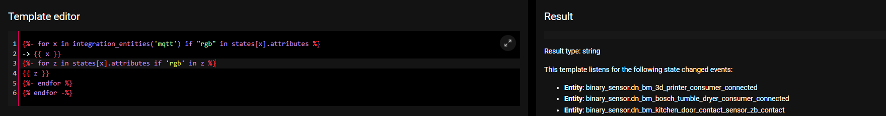

Copy-paste the following template into the Template Editor.
{%- for x in integration_entities('mqtt') if 'rgb' in states[x].attributes %}
{{ x }}
{% endfor -%}
It finds all entities belonging to the MQTT integration, searches each entity’s attributes for an attribute named rgb and, if it finds it, reports the entity’s entity_id.
Assuming it finds an entity, you’ll know its entity_id and whether it’s one you configured manually or possibly it was discovered automatically via MQTT Discovery.

If you want more details about the exact names of the attributes, you can use this enhanced version:
-> {{ x }}
{%- for z in states[x].attributes if 'rgb' in z %}
{{ z }}
{%- endfor %}
{% endfor -%}

Hey guys, sorry to revive this after so long, I’m having 7 similar errors (i think they started appearing recently)
2025-08-17 04:01:18.634 ERROR (MainThread) [homeassistant.components.mqtt] The 'rgb' option has been removed, please remove it from your configuration

The above template returns nothing unfortunately.

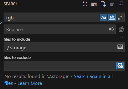

VScode does not find any results in the .storage directory
Any ideas as to how to find the cuprits?

Also, the mqtt filter above did not give any results, which is strange
