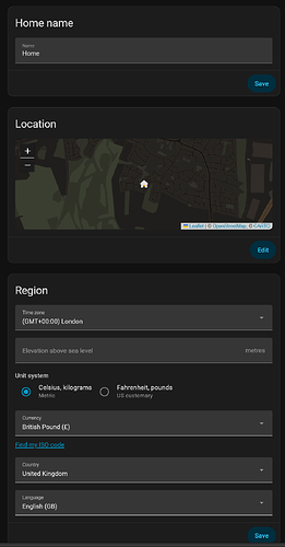

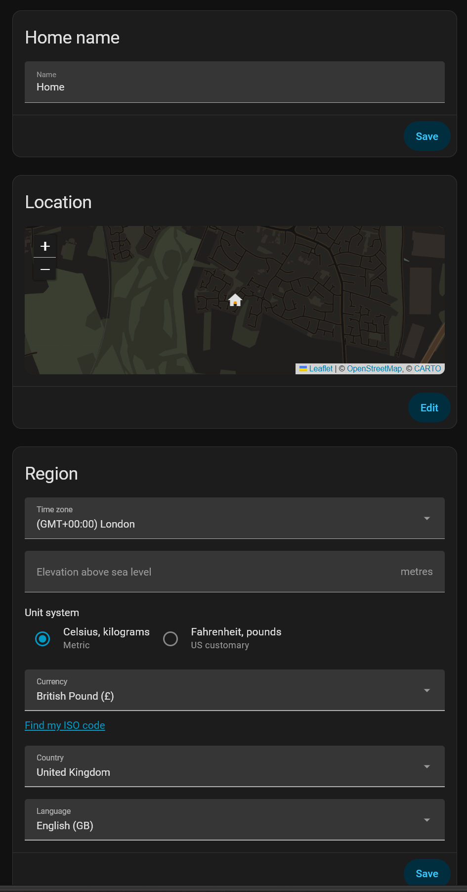

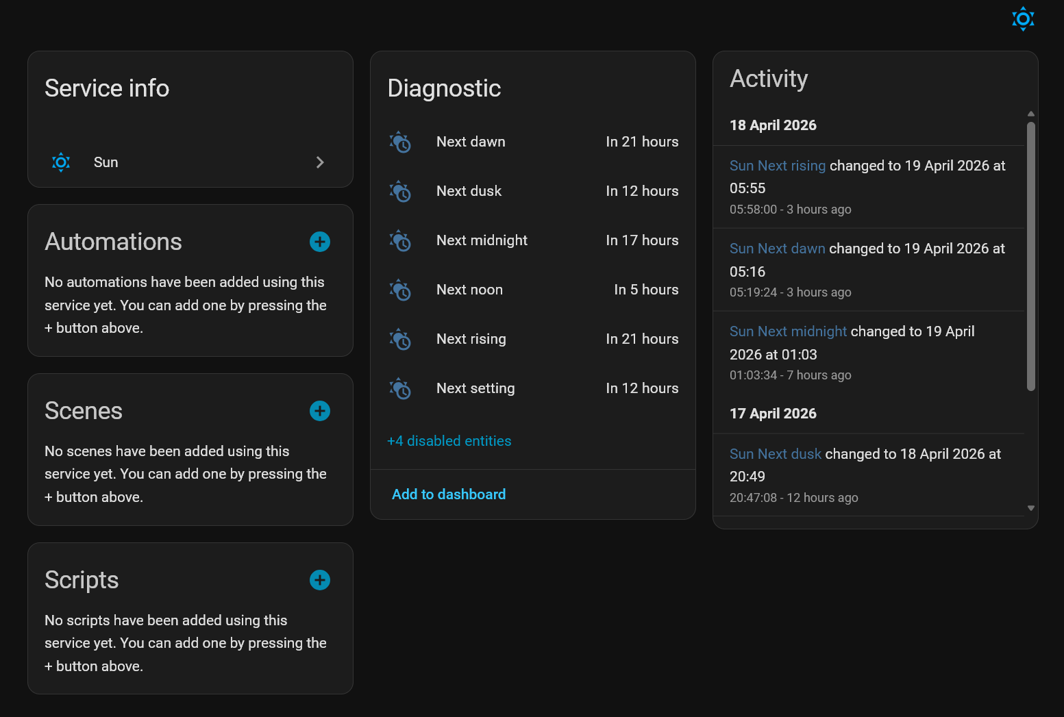

Hello
I am not sure which Screenshots you require, so, I have done two, one of the Sun Service Entities and one of the Home Settings showing the Timezone.
The Screenshots were taken at approximately 08:30.

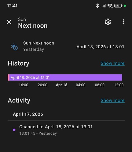

He might have a point about the sun being off by an hour. Just had a look at mine & it shows next noon is at 13:00. It was noon 40 mins ago

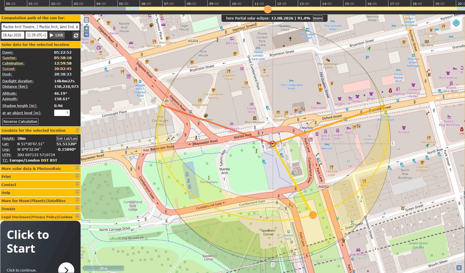

If you wish to check any of the HA values, then I use www.suncalc.org
which shows sun event times and path details for any location, both live and for times in the past and future. It is very easy to centre the map onto your precise location, and the site uses location-timezone lookup to identify your local time as well as DST applicability. You will see, if you select ‘now’ that noon for a location in the UK is around 13:00, but if you change the date to say 18 March then noon jumps back to 12:00 as DST only starts at the last Sunday in March.
Comparing HA and other systems with suncalc should be very accurate for solar noon if you have your location in HA set correctly, however sunrise may well differ very slightly, since different routines will use the formal centre of the sun being visible at the horizon for sunrise, or the tip of the sun being visible, which is about 1 minute different.
Naturally, sunrise is defined related to sea level with view of the sea-horizon, so the sun will almost certainly only ‘rise’ locally once the elevation exceeds the local building/terrain horizon.
Also be aware that suncalc in the live /history mode shows sunrise today, whereas HA shows the next sunrise, which is tomorrow after sunrise today, and this will often be +/- 1-3 minutes different day to day.
For me, noon today is 13:09, and suncalc says it is 13:09:26

Yep, you’re right @Biscuit. Forgot about the difference between solar noon/midnight & what our clocks say due to DST.

Your Sunrise & Sunset times are correct if you compare your screenshots to suncalc or Sunrise and sunset times in London.
Your screenshot shows the next sunrise at 5:55. Site I linked above shows it’s scheduled for 5:56 tomorrow for the general London area. That’s only a minute off, not an hour.
