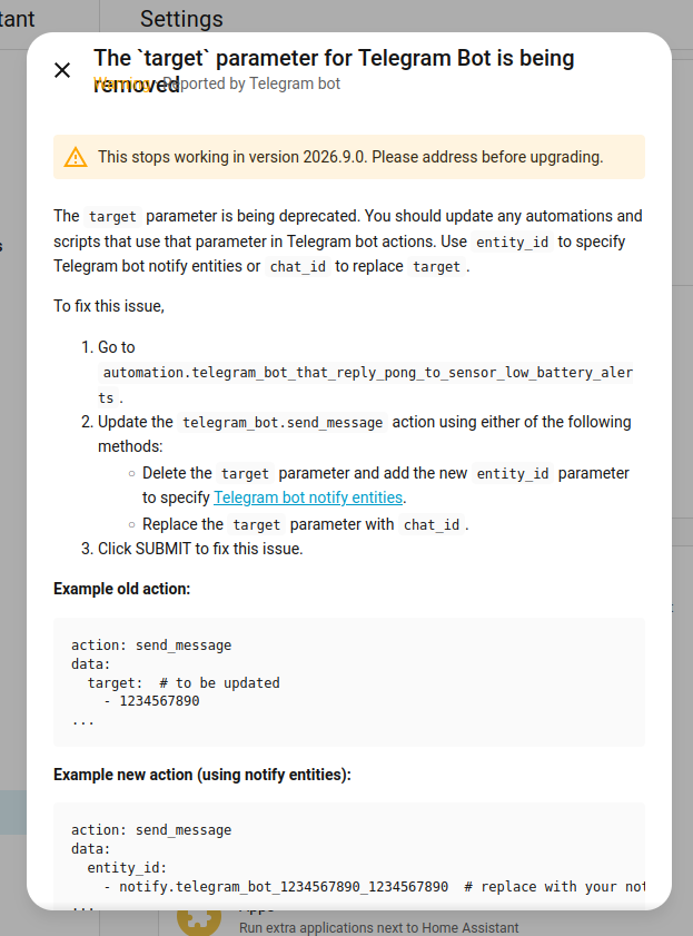

The `target` parameter for Telegram Bot is being removed -- template issue?
Just updated and now have some warnings that the suggested repairs don’t work for…not sure how to “fix” it.
I thought I’d got thru all these but apparently previously I had only done ones where the target was using a ‘notify’ and not dynamic.
The problem is I have no “notify.something” to change it to - I am replying dynamically to the user who sent the message. I really hope I don’t now have to do separate automations for every possible user???

Change this:
  - alias: 'Telegram bot that reply pong to Sensor Low Battery Alerts'
    trigger:
      - platform: event
        event_type: telegram_command
        event_data:
          command: '/check_low_sensor_battery'
    action:
      - service: telegram_bot.send_message
        data_template:
          target: '{{ trigger.event.data.user_id }}'
          message: |
            Check blah
To this:
    triggers: # changed
      - trigger: event  # changed
        event_data:
    actions:  # changed
      - action: telegram_bot.send_message  # changed
        data:  # changed
          chat_id: '{{ trigger.event.data.user_id }}'  # changed
          message: |
            Check blah
The repair is only about the target part but I also corrected some other legacy format you are using. e.g. data_template has not been used since forever.

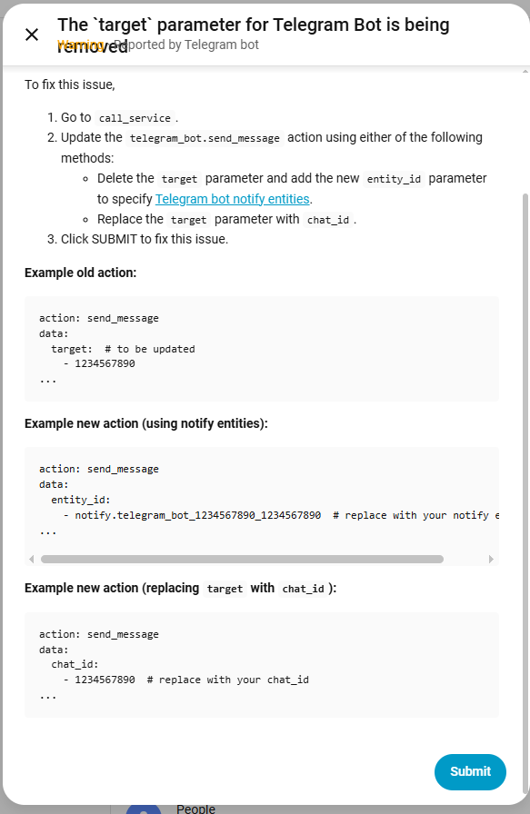

Trying to fix this but I still get the warning popup even after fixing it.
I did a search for telegram_bot.send_message in my config folder and only one search comes up. Changed from target: to chat_id. Restarted HA, but the warning still pops up.
Any suggestions on how to further refine the search? What other search perimeters should I be targeting?
update: so I think the issue is that I still have the old telegram bot integration as suggested here.
I see the new telegram bot has been added. Do I just comment out these old lines and nothing else?? My existing automation should use the new telegram bot integration???

This repair is also coming up if you are using the old method anywhere too.
Don’t forget to check Alarmo notifications if you use it.
ok. I think I have idea of what I need to do. Has this been address with a fix to migrate over the new telegram bot integration??

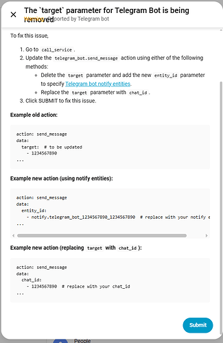

hI @tom_l , any idea why this still results in the persistent notification about target
    - action: notify.home_telegram
        title: '*Garage Presence*'
        message: Triggered due to presence
That is the depreciated format. Use the new format.
        chat_id: # your chat id here
Thank you, I have changed it to the code below, it works:
      chat_id: !secret casabot_chatid
      title: '*Garage Warning*'
      message: Garage just opened

thanks for your assistance, the previous changes removed the warning and work perfectly.
