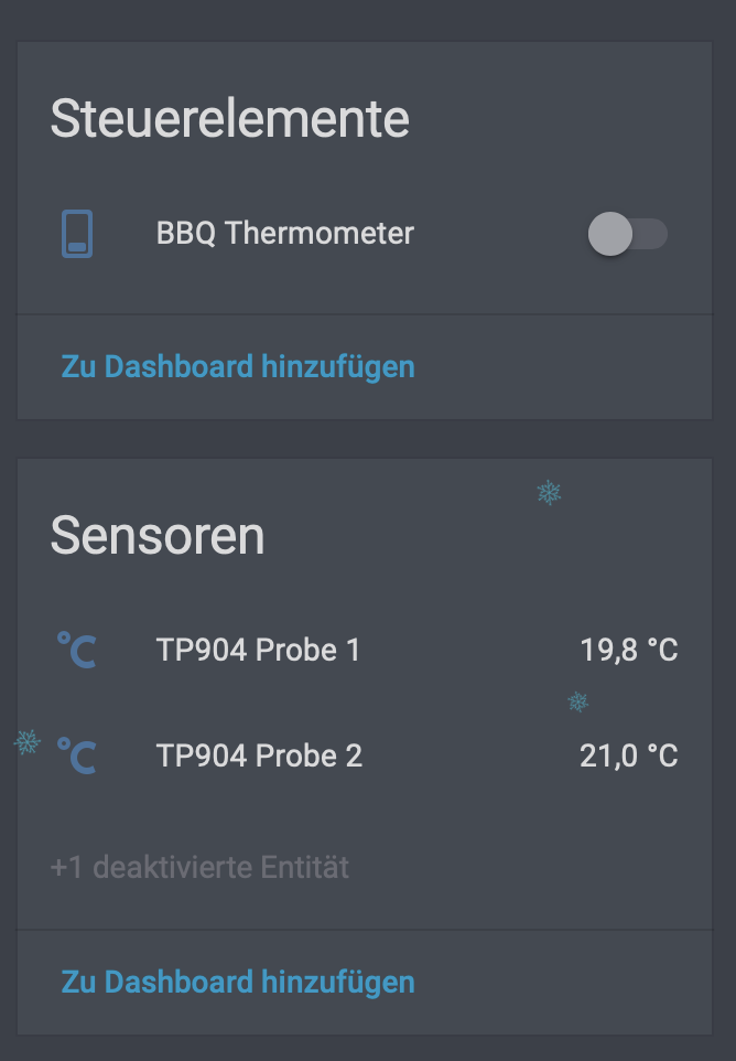

You can uncomment the ---- Publish raw frame as hex string ----part and the text_sensor to see the raw message received through the notified characteristic but its very noisy and for development purpose only.
When using it you have to turn on the switch (and sometimes try this 2-3 times until you see real temperature values).
Feel free to use and share your experience as well as improve it.
