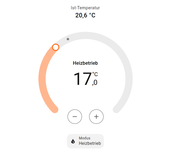

I have some devolo thermostats, radioator-thermostats as well as room-thermostats. They all were recognized by Home Assistant and seem to work well.
They are all show in Lovelace as this
The strange thing is, if I change the target temperature by moving the slider, nothing happens. I verified this by subscribing to the state_changed event within the developer tools and then changing the slider position. Nothing happens … no event is triggered.
I suppose, this is expected behaviour - correct?
If so - is there a way to change this?
Or - perhaps - are there any custom solutions to that? Up to now I haven’t found any nor in HACS, nor any Blueprints …
