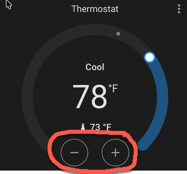

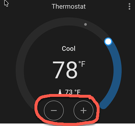

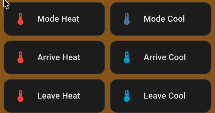

I like the Thermostat card but I want to make it read only and not allow adjustment of temperature. I want to use it on a tablet dashboard where I have created preset temp tiles that will control the temperature. I don’t want users to be able to adjust temp on the Thermostat tile though.
Any thoughts on how to accomlish this?

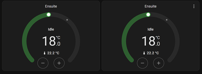

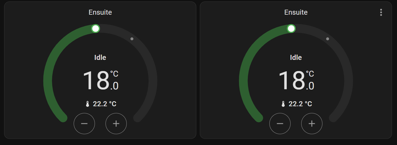

With the help of Claude AI (Original on right):
 * readonly-thermostat-card.js
 * A pixel-perfect read-only thermostat card for Home Assistant.
 * Uses the exact same internal HA component as the built-in thermostat card
 * (ha-state-control-climate-temperature) with a ResizeController that mirrors
 * HA's own sizing logic, then layers a transparent overlay to block all input.
