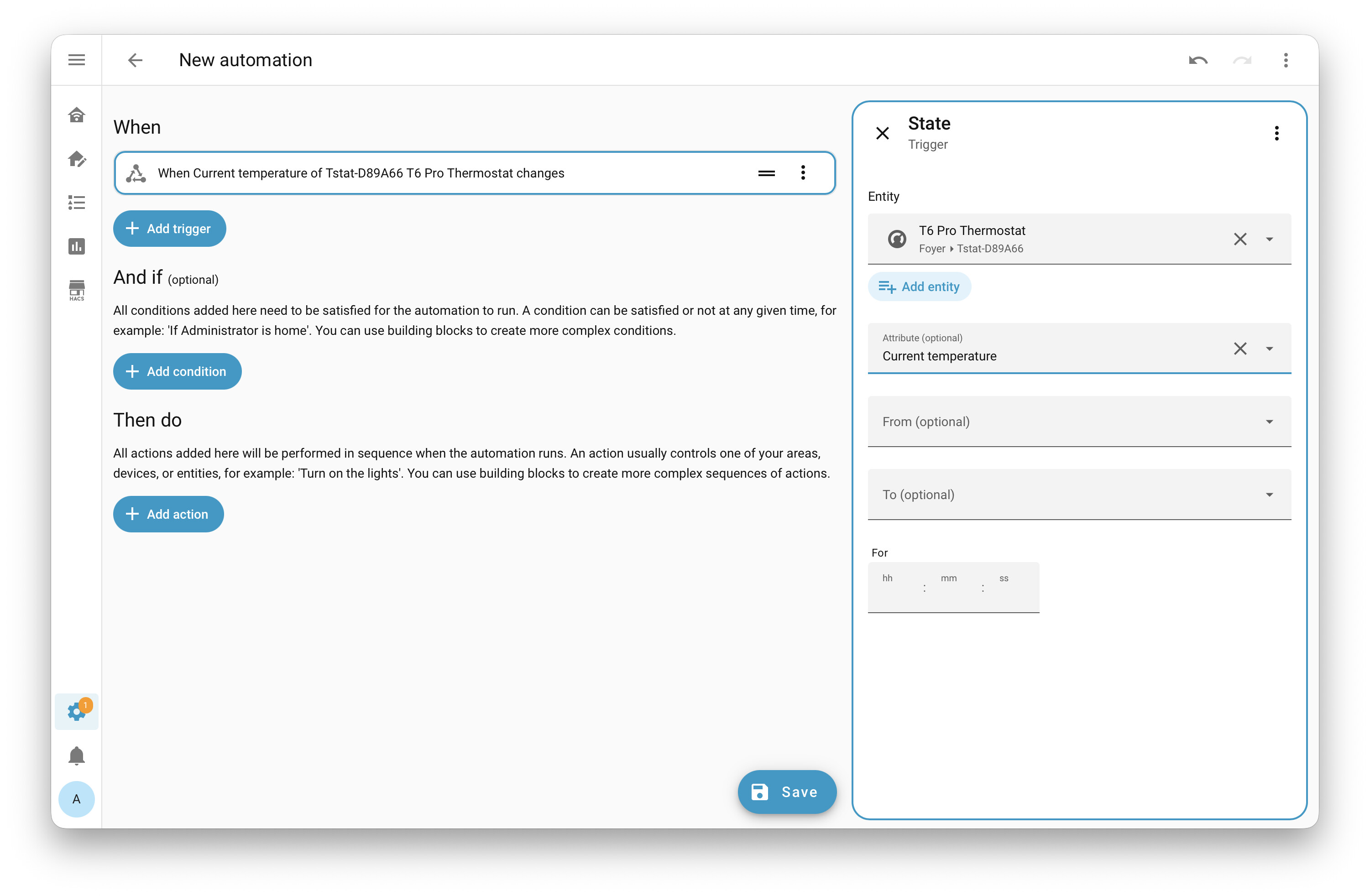

You shouldn’t have to do any YAML for that. Here’s what that same thing looks like in the UI.
I started a new automation, added a trigger, selected and picked the entity trigger. From there you pick the thermostat, then in the attribute part pick the current temperature.
