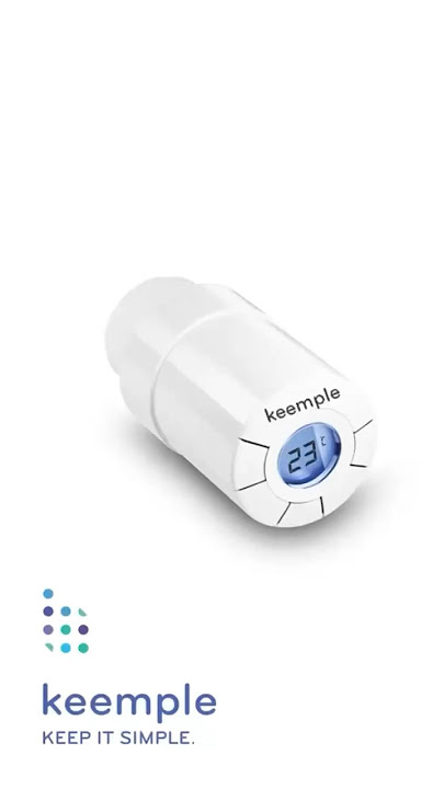

I received most of the Z-Wave devices as part of the apartment package, from the developer. It’s called Keemple
Here I want to talk about 1st version of the Thermostat I got from them.
As I found out it’s rebranded Danfoss LC-13.
The dongle I use is SONOFF Z-Wave 800 Dongle Plus.
The problem is Home Assistant can’t fully discover it. I don’t have temperature options. It says that device is currently being interviewed and may not be fully operational. A few days after I added it.

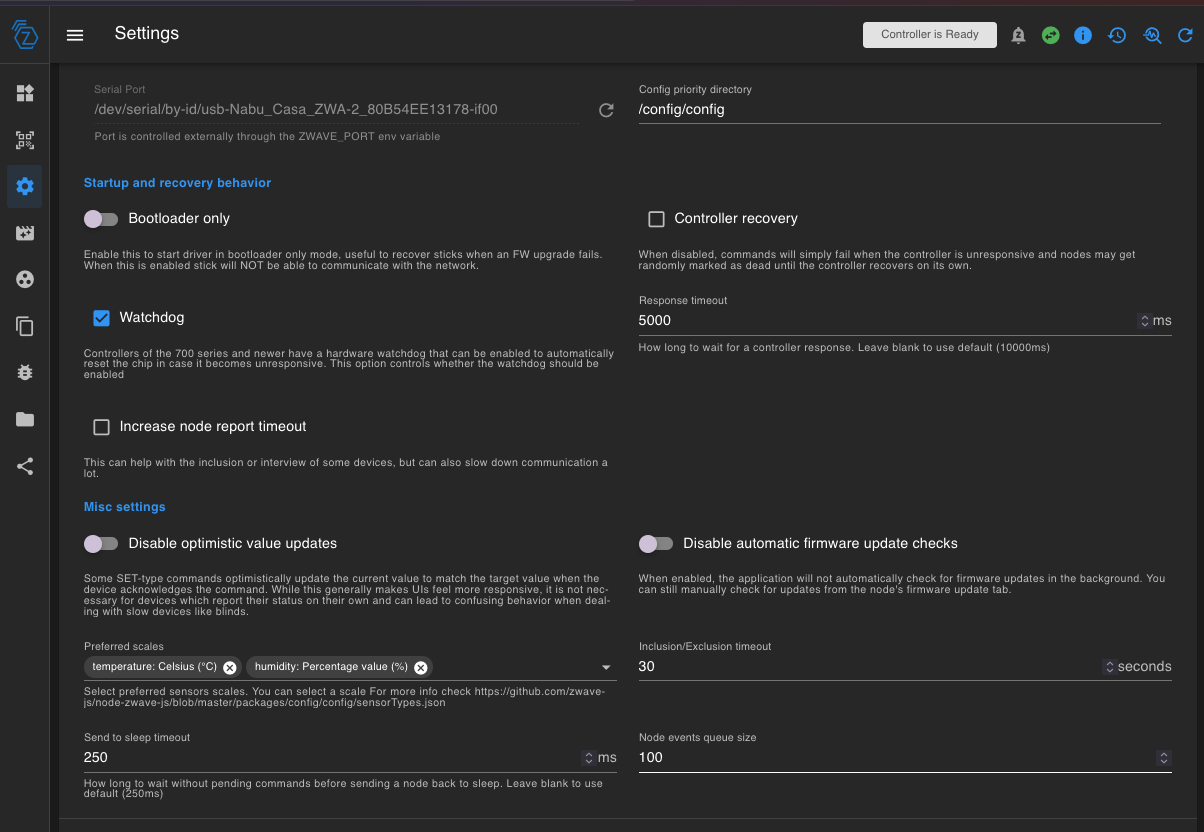

After rediscovering it’s stops at
same problem!
now work fine with this short timings
