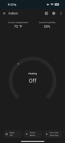

Thermostat off, but running?
How is this state possible? Thermostat is off (according to HomeAssistant) but is actually running (according to HomeAssistant). And it was in fact running (heating). Honeywell T6 z-wave.

I don’t know if this caused my issue, or just uncovered a bug. The thermostat is Off, but clicking the +/- temperature buttons still do something. It may only be cosmetic, but the +/- should probably not do anything when the thermostat is off.
