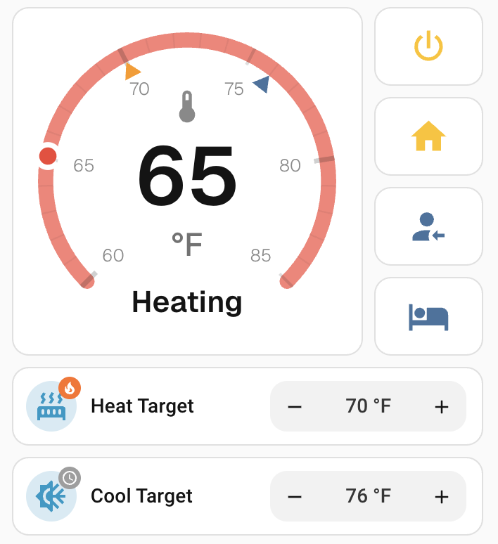

I’m currently trying to tie 2 climate devices together. I saw dual thermostat card but they are switch devices and mine of course are climate devices.
One is for instance heat → climate.thermostat
one is for cooling → climate.johns_device
Is there currently a way to use both of them on a single thermostat card? I’m either making this way to hard or missing something.
Thank in advance!!
And what protocol are you using?
Maybe you can if you are using z2m to put them in the same group.
No, it’s hard. With the dual thermostat you would need to define a couple helper switches for heating and cooling that trigger the two climate devices you already have. I had limited success going that route, and I looked and looked for alternatives and never found anything.
I finally ended up using the Ring card, some helper switches, and a little automation to allow me to have a single view of the two climate devices. I wouldn’t recommend that path either, but it is working for me now.
Thank you all! Sounds like I’m just going to have keep two different cards… one for heating, one for cooling…
