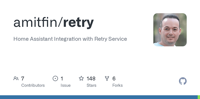

I have a different Honeywell thermostat and occasionally a call to set the temperature fails. I use the Retry custom integration to work around the issue.
