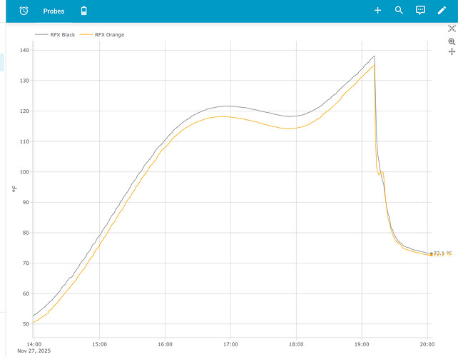

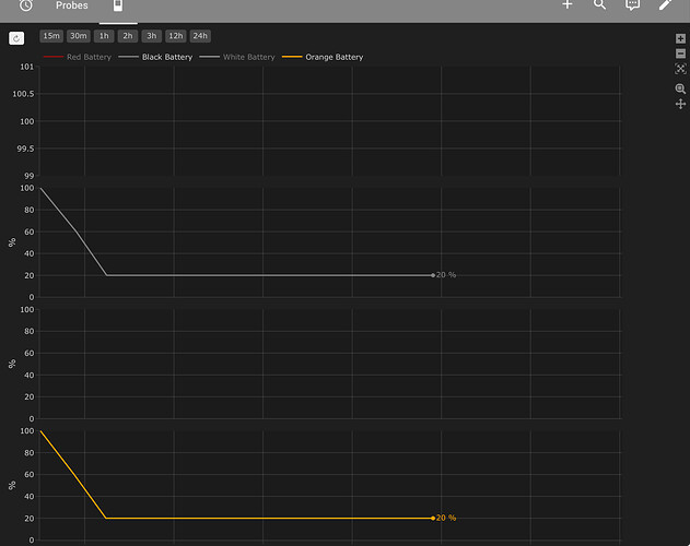

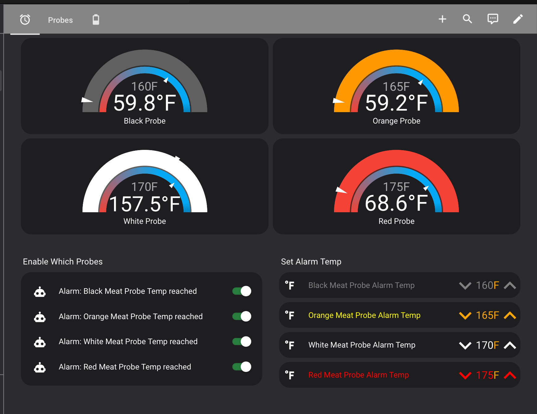

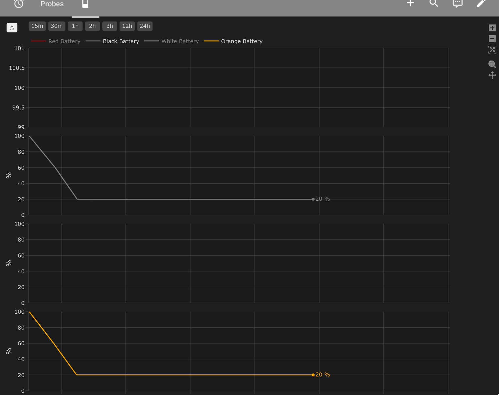

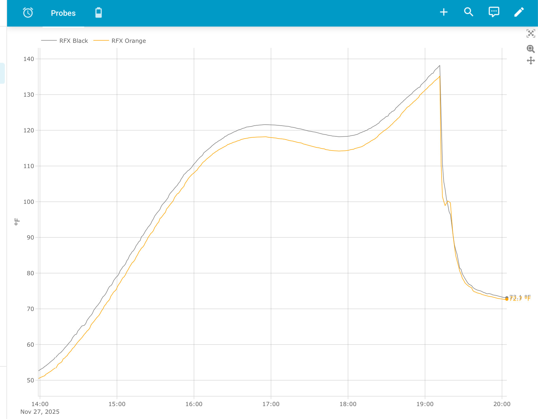

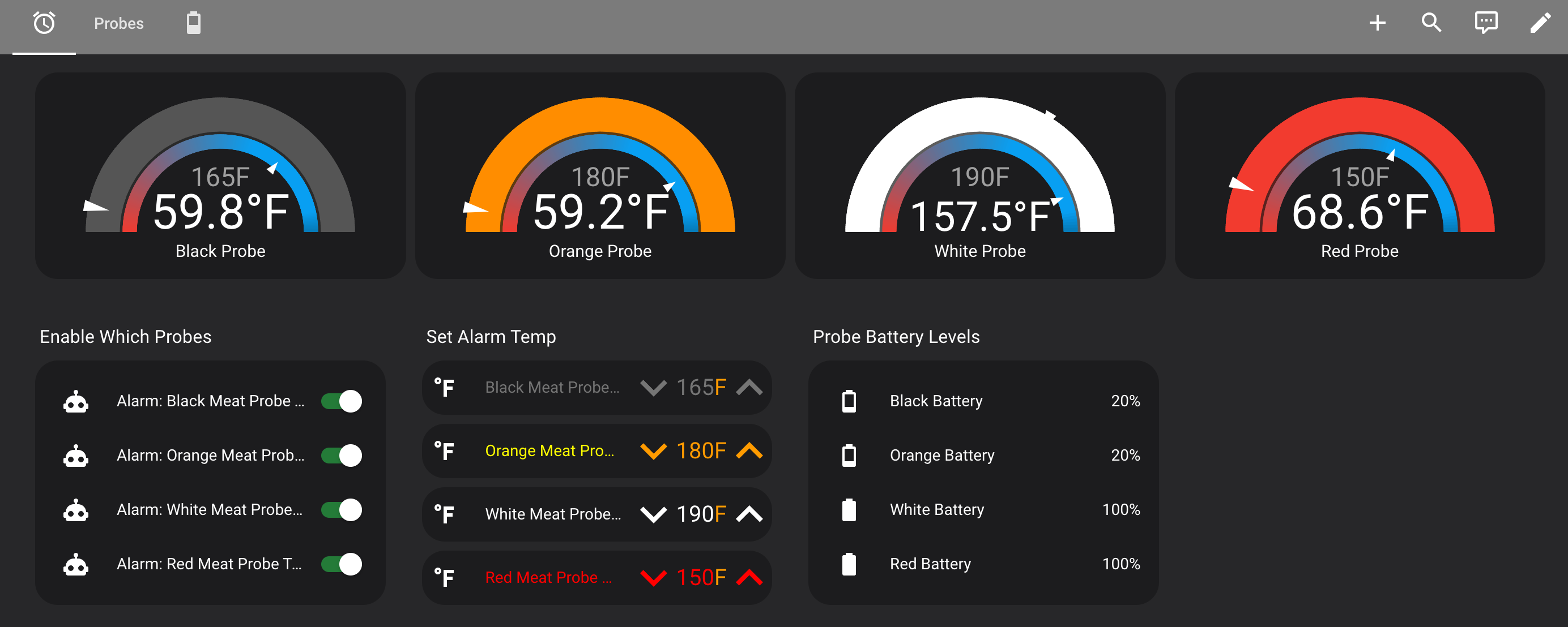

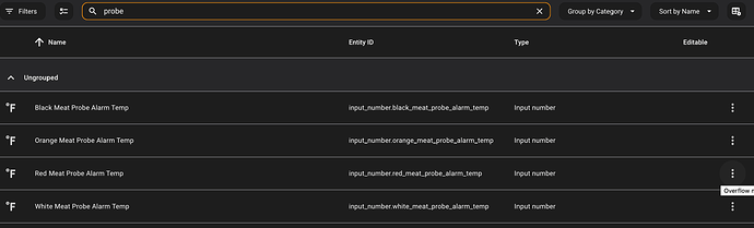

This is what I have so far. I’m sure it can be prettied up by you guys :slight_smile:
There are 3 tabs to the dashboard
Overview Tab:

        inner:
          min: 50
          max: 210
          mode: needle
          gradient: true
          segments:
            - from: 50
              color: var(--red-color)
            - from: 150
              color: var(--light-blue-color)
            - from: 200
            - from: 250
              color: var(--black-color)
          gradient_resolution: medium
        gradient: true
        gradient_resolution: high
        value_texts:
          primary: "{{ states(entity) | float | round(1) }}°F"
          secondary: "{{ states(entity2) | float | round(0) }}F"
          secondary_color: "#aaa"
        titles:
          primary: Red Probe
        visibility:
          - condition: state
            entity: automation.alarm_red_meat_probe_temp_reached
            state: "on"
    column_span: 4
  - type: grid
    cards:
      - type: heading
        heading: Enable Which Probes
        heading_style: title
      - type: entities
        entities:
          - entity: automation.black_meat_probe_temp_reached
          - entity: automation.orange_meat_probe_temp_reached
          - entity: automation.alarm_white_meat_probe_temp_reached
          - entity: automation.alarm_red_meat_probe_temp_reached
  - type: grid
    cards:
      - type: heading
        heading: Set Alarm Temp
      - type: custom:numberbox-card
        border: true
        entity: input_number.black_meat_probe_alarm_temp
        min: 60
        max: 225
        unit: F
        speed: 200
        icon_plus: mdi:chevron-up
        icon_minus: mdi:chevron-down
        delay: 750
        step: 5
        card_mod:
          style: >
            .cur-num{font-size:20px !important}
            .cur-num.upd{color:green}
            .cur-unit{color:orange; font-size:100% !important; opacity:1
            !important}
            .grid-left{color:grey}
            .grid-right{color:grey}
            .cur-box ha-icon{transform:scale(2)}
        visibility:
          - condition: state
            state: "on"
        border: true
        entity: input_number.orange_meat_probe_alarm_temp
        min: 60
        max: 225
        unit: F
        speed: 200
        delay: 750
        step: 5
        card_mod:
          style: >
            !important}
            .grid-left{color:yellow}
            .grid-right{color:orange}
        visibility:
          - condition: state
            state: "on"
        border: true
        entity: input_number.white_meat_probe_alarm_temp
        min: 60
        max: 225
        unit: F
        speed: 200
        delay: 750
        step: 5
        card_mod:
          style: >
            !important}
            .grid-left{color:white}
            .grid-right{color:}
        visibility:
          - condition: state
            state: "on"
        border: true
        entity: input_number.red_meat_probe_alarm_temp
        min: 60
        max: 225
        unit: F
        speed: 200
        delay: 750
        step: 5
        card_mod:
          style: >
            !important}
            .grid-left{color:red}
            .grid-right{color:red}
        visibility:
          - condition: state
            state: "on"
cards: []
icon: mdi:alarm
Battery graphs tab:

     - type: custom:gauge-card-pro
       entity: sensor.rfx_black_temp
       entity2: input_number.black_meat_probe_alarm_temp
       needle: true
       min: "50"
       max: 210
       segments:
         - from: 50
           color: var(--dark-grey-color)
       inner:
         min: 50
         max: 210
         mode: needle
         gradient: true
         segments:
           - from: 50
           - from: 150
           - from: 200
           - from: 250
       gradient: true
       value_texts:
       titles:
         primary: Black Probe
       visibility:
         - condition: state
           state: "on"
       entity: sensor.rfx_orange_temp
       entity2: input_number.orange_meat_probe_alarm_temp
       needle: true
       min: "50"
       max: 210
       segments:
         - from: 50
           color: var(--orange-color)
       inner:
         min: 50
         max: 210
         mode: needle
         gradient: true
         segments:
           - from: 50
           - from: 150
           - from: 200
           - from: 250
       gradient: true
       value_texts:
       titles:
         primary: Orange Probe
       visibility:
         - condition: state
           state: "on"
       entity: sensor.rfx_white_temp
       entity2: input_number.white_meat_probe_alarm_temp
       needle: true
       min: "50"
       max: 210
       segments:
         - from: 50
           color: var(--white-color)
       inner:
         min: 50
         max: 210
         mode: needle
         gradient: true
         segments:
           - from: 50
           - from: 150
           - from: 200
           - from: 250
       gradient: true
       value_texts:
       titles:
         primary: White Probe
       visibility:
         - condition: state
           state: "on"
       entity: sensor.rfx_red_temp
       entity2: input_number.red_meat_probe_alarm_temp
       needle: true
       min: "50"
       max: 208
       segments:
         - from: 50
       inner:
         min: 50
         max: 210
         mode: needle
         gradient: true
         segments:
           - from: 50
           - from: 150
           - from: 200
           - from: 250
       gradient: true
       value_texts:
       titles:
         primary: Red Probe
       visibility:
         - condition: state
           state: "on"
   column_span: 4
 - type: grid
   cards:
     - type: heading
     - type: entities
       entities:
 - type: grid
   cards:
     - type: heading
       border: true
       min: 60
       max: 225
       unit: F
       speed: 200
       delay: 750
       step: 5
       card_mod:
         style: >
           !important}
       visibility:
         - condition: state
           state: "on"
       border: true
       min: 60
       max: 225
       unit: F
       speed: 200
       delay: 750
       step: 5
       card_mod:
         style: >
           !important}
       visibility:
         - condition: state
           state: "on"
       border: true
       min: 60
       max: 225
       unit: F
       speed: 200
       delay: 750
       step: 5
       card_mod:
         style: >
           !important}
           .grid-right{color:}
       visibility:
         - condition: state
           state: "on"
       border: true
       min: 60
       max: 225
       unit: F
       speed: 200
       delay: 750
       step: 5
       card_mod:
         style: >
           !important}
       visibility:
         - condition: state
           state: "on"
cards: []
icon: mdi:alarm

Create these helpers:
And finally, these template sensors to your sensor configuration

Sheesh, it took me almost as long to write this post as it took to program all of it :slight_smile:
But I use this A LOT. There’s cooking before RFX and then there’s real cooking after having RFX.
Thanks for posting your YAML code. I tried recreating the RFX tabs in my HA instance, but it looks like the code you posted for the individual probe graphs and the battery graphs tab is exactly the same as the overview tab code posted (for alarms). Any chance you can check that and repost the probe and battery graph YAML? Thanks!
Try this
Probes
type: panel
    defaults:
      entity:
        show_value: true
      yaxes:
        side: left
        overlaying: "y"
        visible: true
        showgrid: true
        fixedrange: true
    entities:
      - entity: sensor.rfx_red_temp
        internal: >-
          $ex hass.states['automation.alarm_red_meat_probe_temp_reached'].state
          !== 'on'
        line:
          color: red
          shape: spline
          width: 1
          smoothing: 0
      - entity: sensor.rfx_black_temp
        internal: >-
          $ex hass.states['automation.black_meat_probe_temp_reached'].state !==
          'on'
        line:
          color: grey
          shape: spline
          width: 1
          smoothing: 0
      - entity: sensor.rfx_white_temp
