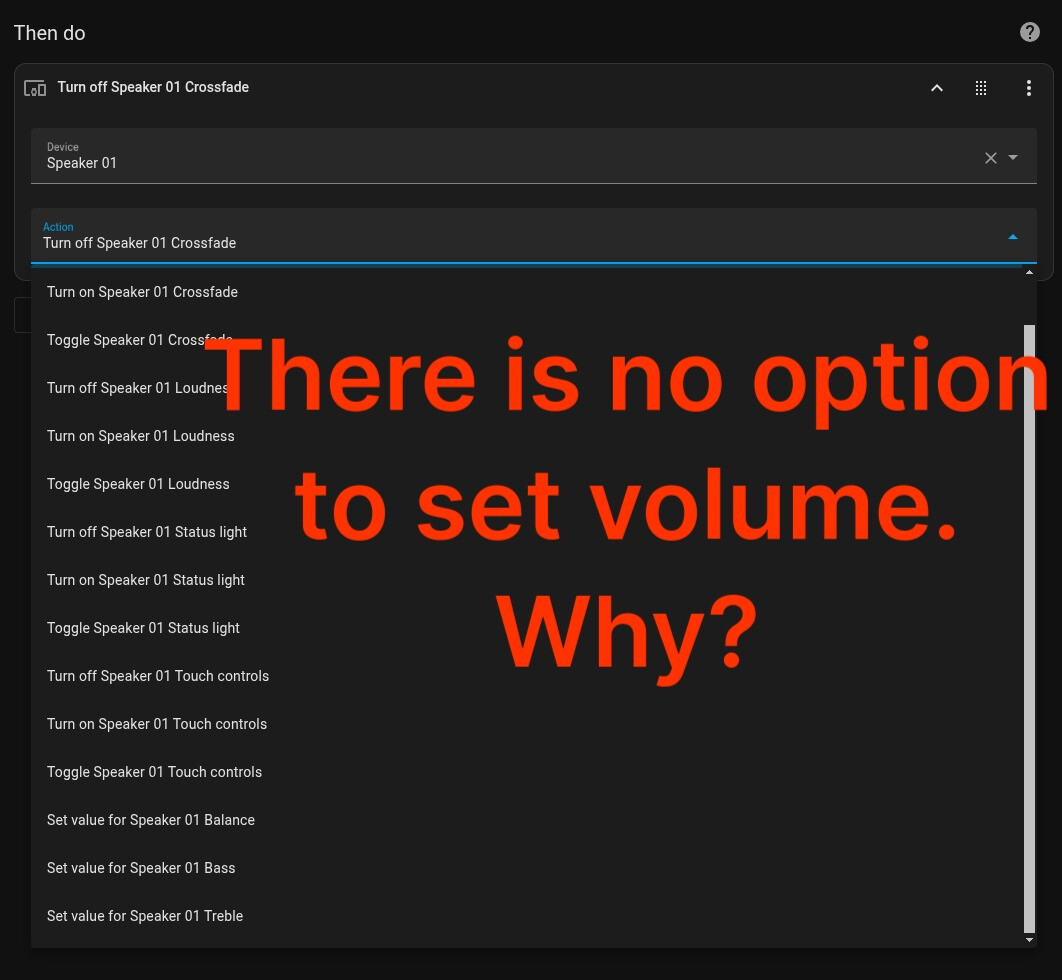

  2. Sonos Volume Control: I have Sonos speakers with the Sonos integration. In the device page for the speakers, I can adjust the volume under Controls. However, I don’t seem to be able to adjust/set the volume in an automation. I would like to be able to adjust the volume to make sure a TTS message isn’t too loud or too quiet. HA is clearly capable of doing this, so I don’t understand why it’s not available in automation as far as I can tell.

I don’t have a Sonos, but generally speaking if there is a “media_player” entity with volume support, then you can add an automation action for media_player.volume_set or volume_down. When you click “Add Action” choose “Media Player” and look for volume controls.

I’m not using code. See first image (system won’t let me attach more than one), which describe what I am saying.

For the Sonos issue, use the “Media Player” when you’re in the “Add Action” prompt–not “Device.” Then find the media player that corresponds to your Sonos. There is a “Set Volume” option once you do that.

@peterxian @d921 You are correct. The volume option is under media player, which I did not expect.
I must be missing something about how these items are organized. The speaker is a device, and the volume of the speaker is a property of that device, so I would expect to see its control under said device.
