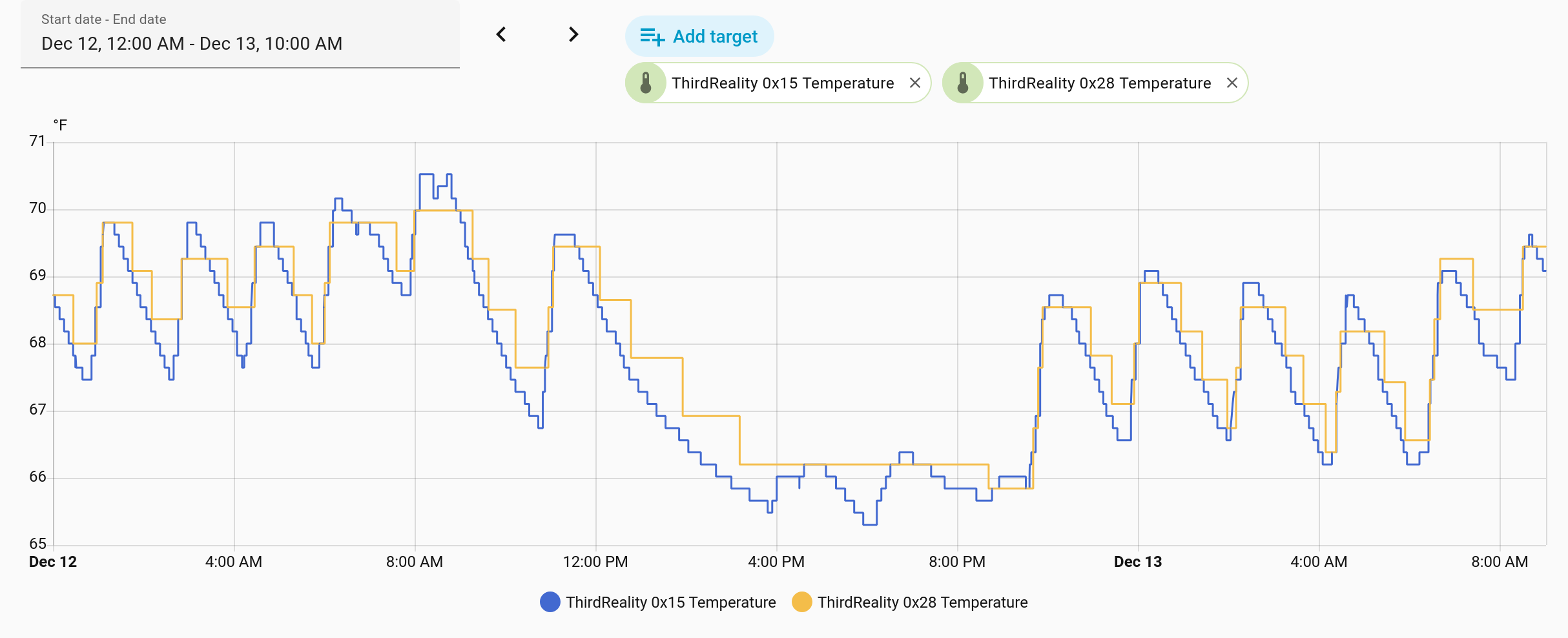

I have 4 ThirdReality temp + humidity sensors (the ones with an LCD and AA batteries, 3RTHS24BZ). Two from a couple years ago and two brand new. One old sensor still has the old firmware, 0x15. The other three are up-to-date, 0x28.
This graph shows old & new firmware from sensors that are 1’ apart. ThirdReality seems to have slowed down the update rate and increased the temperature change threshold for reporting. It’s much worse on both axes.
Can anyone help with any of these paths forward?
  1. Rolling back to an older firmware.
  2. Configuring the new firmware for useful time/temperature resolution
  3. Buying other Zigbee sensors with similar resolution to the old ThirdReality firmware
  4. Any other suggestions…

  2. The issue I’ve described here on the LCD sensors newer firmware:
    • They have bad time resolution (update slowly), but give fine temperature resolution.
    • For example, it only updates every 15 or 30m. But when it does, you’ll get a real value with 0.1F precision.
Thanks again for digging up that thread on their forums, I couldn’t find any good info like that when I was debugging those sensors earlier this year.

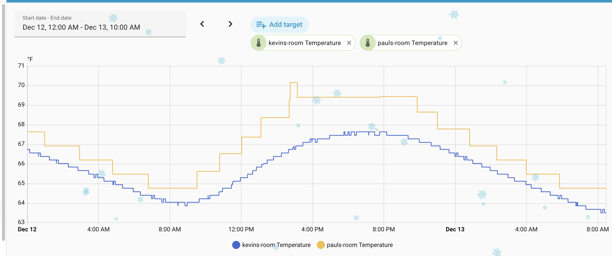

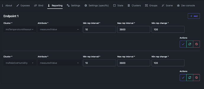

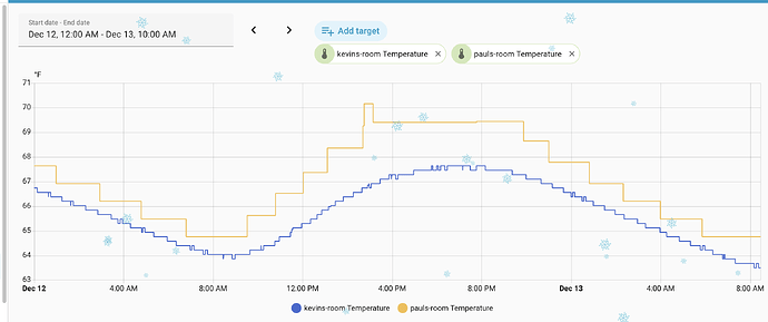

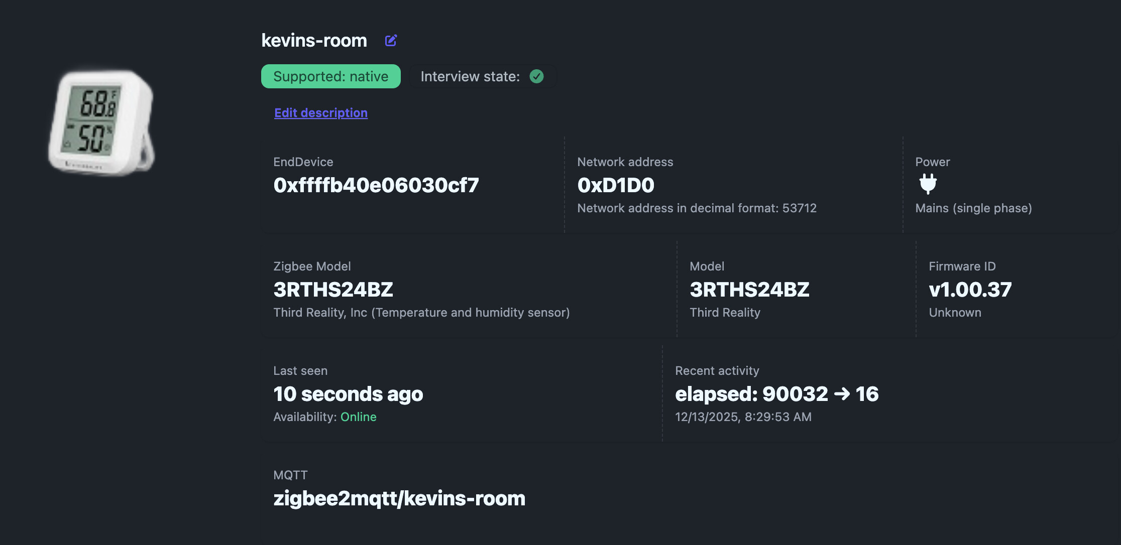

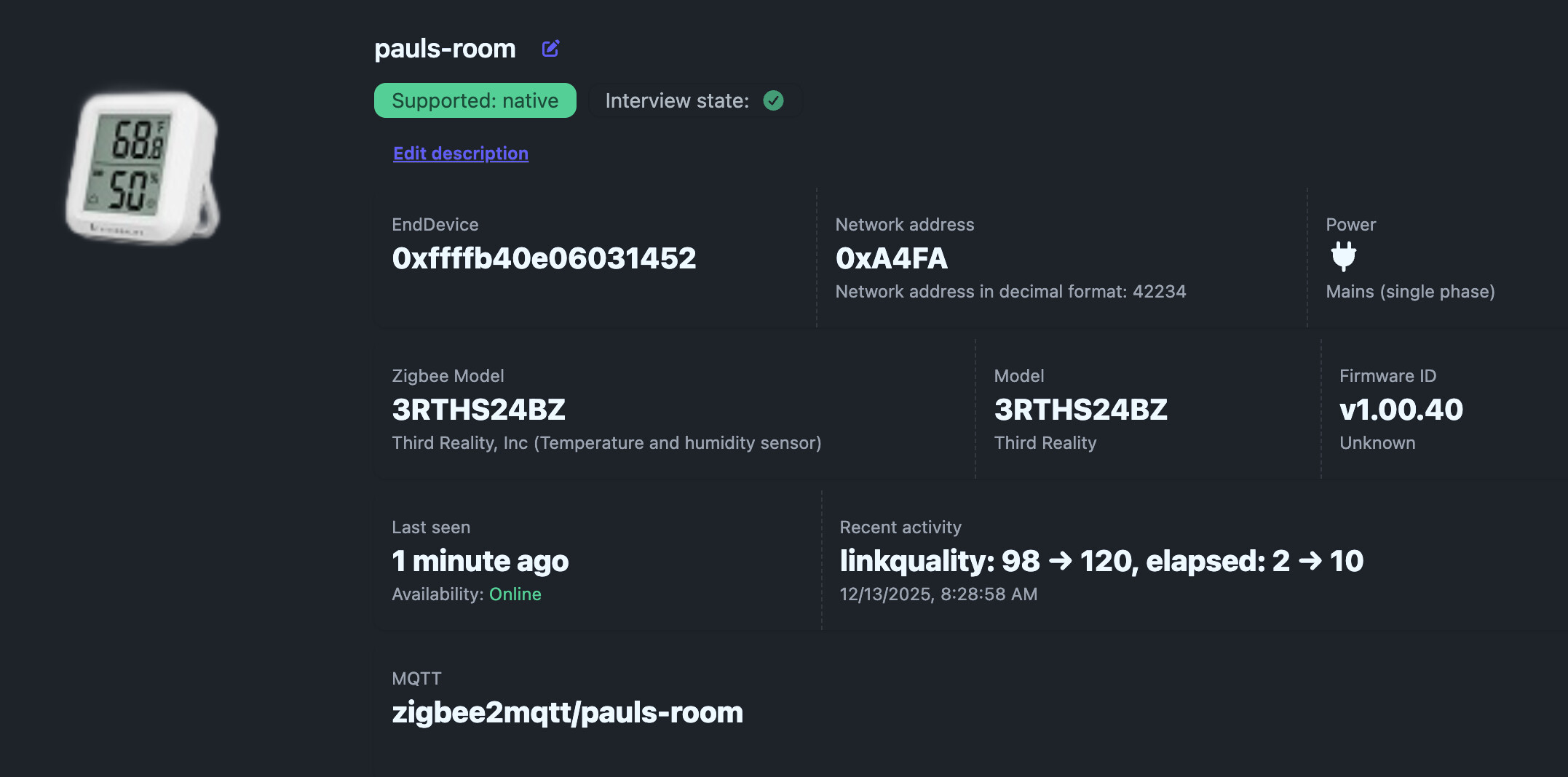

Blue line is .37 firmware, yellow line is .40 firmware. Other pictures for reference of setup of Zigbee2MQTT.
Hope they improve their firmware, else I am going back to BLE thermometers. I abandoned Zigbee temperature sensors for BLE sensors a number of years ago. Found the 3rd Reality units with firmware .37 and found them to be as solid as the BLE devices I was using.
Lesson is don’t upgrade firmware of something that is working. And have a test environment for firmware and other changes before changing production systems (sux that u have to do this, in this day and age) .
