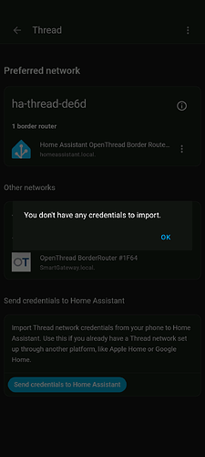

unable to copy credentials. This is the failure point. I know of no solution, as I followed the path.
see @WallyR comment again, in your screenshot we see send credentials to Homeassistant, but you want to send the credentials from Homeassistant to your phone.
I think you should only see #de6d network, what is the network under “other”?
For your preferred Thread Network (-de6d), click on the 3-dots and choose the setting to use the credentials for ios/android. You should then see a “key-in-phone” icon which means HA will use this network’s creds for sending to the phone.
