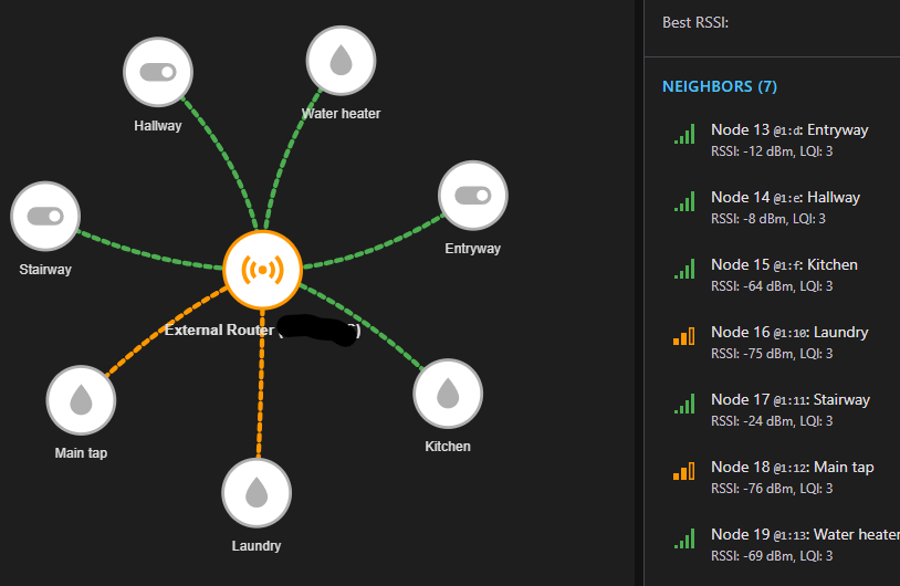

Having found the Thread Mesh map under the Matter server options (enable the beta version under config, then Open Web UI), I can see that even with the IKEA ALPSTUGA AQ sensors acting as routers network quality is not at all great because of the location of the TBR (stuck in a corner). Having a TBR in a more central location will improve things greatly.
Not really sure about that. The alpstugas are not-so-good routers due to their low output power (3dbm, it’s in the manual). Kajplats bulbs are better for that purpose (10dbm). In the grand scheme of things, it doesn’t really matter as the mesh is self-forming, self-healing, self-maintaining. You just need to have enough mains powered devices, the mesh will work it out.
In this instance it should - agreed the ALPSTUGAs aren’t great, but that’s compounded by the current TBR being in one corner, and then all 3 of them being in rooms quite a distance from said TBR. Moving the TBR somewhere they can all “see” it more clearly will definitely help.
The beta HA thread visualization page shows that my setup is radial (no mesh formed) - since all my thread devices are IKEA battery sleepy endpoints. Fortunately the TBR (Aqara M100) can be placed in a central spot that reaches the basement as well as upstairs devices.

I’d like to use the visualization to verify that my switch installation built a good mesh. I’ve updated to 2.16.4 a number of days ago and the system has been restarted during that time . I’m not seeing a link in either devices and services or Apps. Do you know how I get myself there?
Credit goes to PrinterElf for describing how to get there "Having found the Thread Mesh map under the Matter server options (enable the beta version under config, then Open Web UI).
I have HA container rather than supervisor so for me the Web UI is on port 5580. Either way the the Thread page should be a navigation button on the top right:
That got it! I hadn’t drilled down to find enable beta setting. Everything is functioning fine, including my mesh. Initially the red and some of the dashed lines threw me off. Only seeing red and orange threw me off as well, eg no green.
But after looking around at how to read the diagram, it looks like things are pretty healthy and my choice to put to inovelli fan switches at intervals on the second floor built a solid mesh.
Thank you and @PrinterElf !
Good to hear, although for me anything in red used to drop out momentarily every couple of days, so it was worthwhile playing with placement to get everything to green or at least orange.

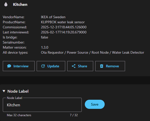

Another handy-dandy feature I found: You can set custom node labels by clicking on a node detail, then Endpoint 0, then BasicInformation, then enter Node Label:
