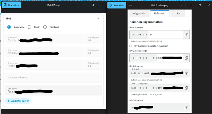

Are your phone, matter server and HA on the same network and is IPv6 enabled in HA and on the network devices?
I am not an expert, but i suppose it is enabled:
That looks like it is enabled.
And iPhone is on heimnetz too?
