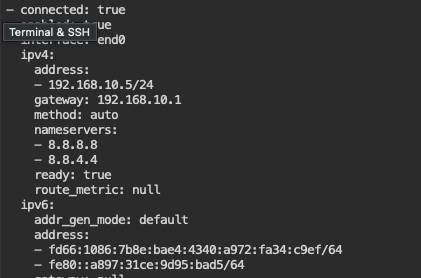

I’m using a Fortinet Software Switch Interface, that combines a wired and a wireless network.
My HA instance has IPv6 configured and so have the devices on this network.

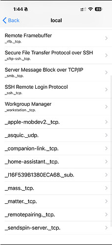

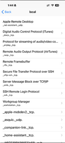

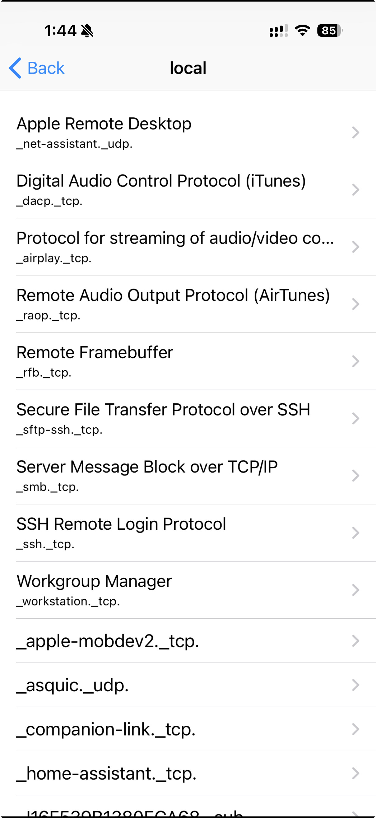

I downloaded the app DNS-SD Browser on my iphone, and the truth is I don’t see
__meshcop.udp
as described here
any ideas?
