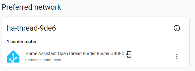

I had set up OpenThread Border Router with a SMLIght SLZB-7, with most current Thread Firmware ( Openthread RCP). OTBR is configured and running, Otbr-agent log file indicates: “Successfully sent discovery information to Home Assistant.”
The setup seems fine, Thread shows this screen
