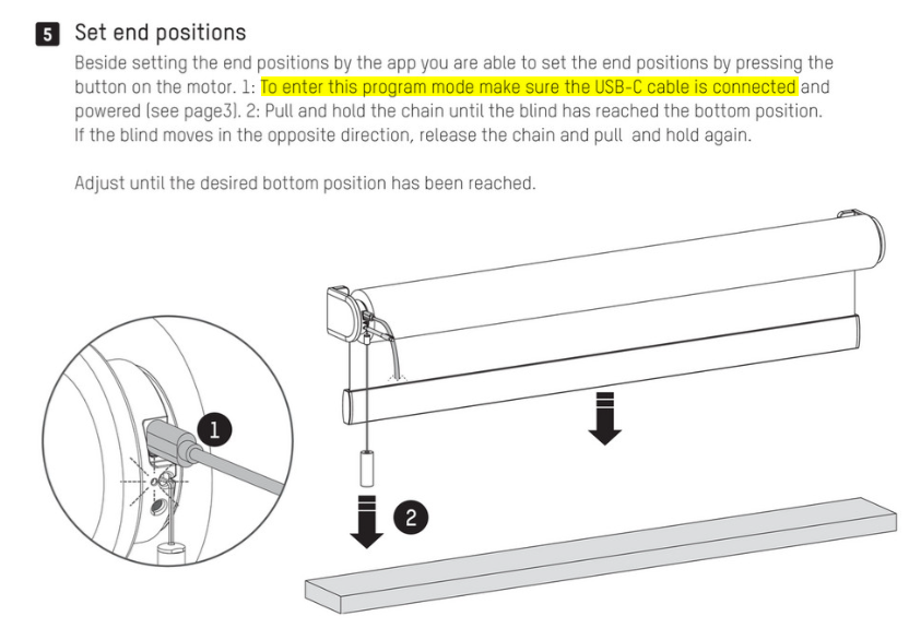

Turns out the issue was solvable — the missing piece was programming the top and bottom positions of the blinds.
Without these set, the up and down commands from Matter aren’t executed — presumably as a safety precaution by the blind manufacturer.
:white_check_mark: Solution:
Program the top and bottom positions, and the blinds will respond to commands as expected.
:hammer_and_wrench: How to do it:
Eve Matter blinds only save the top and bottom positions when a USB cable with a battery is plugged into the device. Here’s the procedure:
  1. Plug in the USB battery.
  2. Move the blind to the desired lower position.
  3. Press the white round button until the blind wiggles slightly (up and down).
  4. Repeat the same steps for the upper position.
:warning: The Catch:
If you follow this procedure without the USB battery plugged in, the blinds will still wiggle when you press the button — but the position won’t be saved. That fooled me.

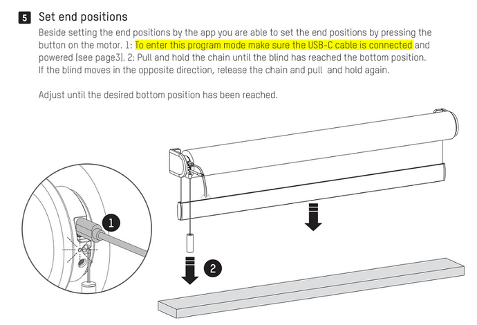

The catch: highlighted
Another twist: Eve offers several motors that look almost identical. The two manuals included in the box I received (and most online guides) describe the setup for Bluetooth motors, which don’t require a USB battery for programming. Tricky!
All sorted now — and looking forward to more shade in the house :sun_with_face:
Sorry I don’t often look on this site. But indeed for this motor we needed an additional button for setting the end limits. Unfortunately that’s a bit difficult to add afterwards. Because we don’t want to sell additional remotes that end up in drawers we made the button change function when inserting the USB-C cable. Now this button acts as a end position button.
