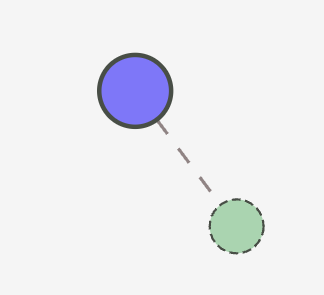

but if I got into the OTBR web interface the topology suggests it is there (there isn’t anything to detail what it is actually showing)
