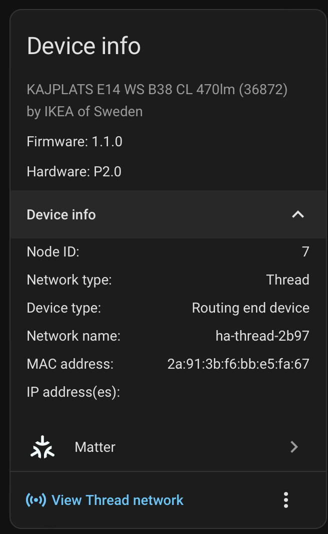

Last week I commissioned six Ikea KAJPLATS lightbulbs successfully; get hass_otbr up and running, set up IV6, etc. all fine. Today, they’re all showing as unavailable in HA, even though they are still connected to the border router. In HA, the Device Info panel for the matter devices is showing correct MAC address and network name, but wrong Node IDs (old ones, I suspect) and no IP addresses.
But haos_otbr knows their IP addresses correctly:

HA instance can ping these IP addresses; but it seems like it’s not getting the IP address information from OTBR - maybe because its idea of the node IDs is wrong? I’ve tried restarting the OTBR and the Thread and Matter integrations in HA, but nothing obvious yet. Anyone seen something like this?
