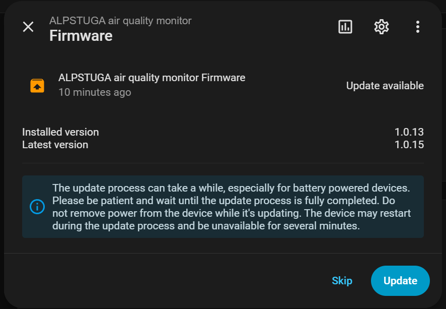

Hey, just leaving this here if it helps anyone… I also have not been able to connect new Ikea matter devices until I got to this post. Since I am not using an apple phone like in the linked post I went to android companion app SETTINGS > Companion App > Troubleshooting > And clicked on Sync Thread credentials… And I could connect all devices without problems…
I played around with getting IKEA MYGGSPRAY and ALPSTUGA working with Thread/Matter for hours last night and couldn’t get it working. I have all the IPv6 stuff configured properly. I have the ZBT-1 for Thread, my ZBT-2 does Zigbee.
Tonight, I went over to my sister’s and spent another 2 hours trying to get her IKEA devices (same two) working, but neither would connect. After doing a full power-down, waiting 10 seconds, and powering back up, only her MYGGSPRAY connected.
Reading through various threads, I found that upgrading to Beta could do it. After I got home, I upgraded to beta for both Matter Server and OpenThread Border Router:
After doing that, I tried connecting my IKEA MYGGSPRAY and ALPSTUGA, and both connected on the first try! Nothing special, didn’t have to go next to the ZBT-1, etc. Also note, I have Zigbee, Z-Wave, Wi-Fi, and Bluetooth devices, and my house has over 150 Wi-Fi devices and 150 Zigbee devices. The fact that these connected so easily is awesome! This is how it should’ve been working this whole time!
After getting these connected, the MYGGSPRAY didn’t have any updates, but the ALPSTUGA did:
Because it acts as a Thread router, I think that’s why this particular device had a firmware update. I bet that’s buggier than end devices.
I went back and remotely upgraded my sister’s Matter/Thread add-ons to Beta, but it kept erroring that it was already in use. After restarting her Raspberry Pi, it was finally on the Beta version, but her MYGGSPRAY disconnected
. Without being over there, I can’t try to reconnect it.
