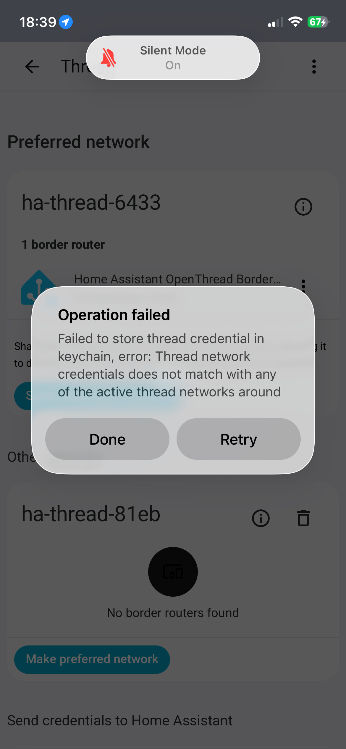

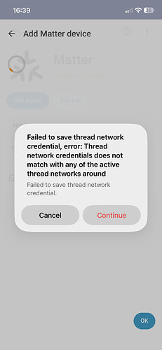

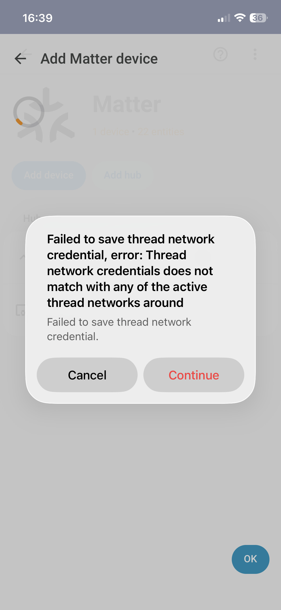

I setup thread yesterday, I added 1 device and it worked fine, I came to add the next device and it came up with this but the connected device still worked.
I did a restart, reboot, but nothing helped. I decided to remove everything which made things much worse.
Now I'm getting this message
there are no thread credentials, so I tried another iPhone, exactly the same :frowning:

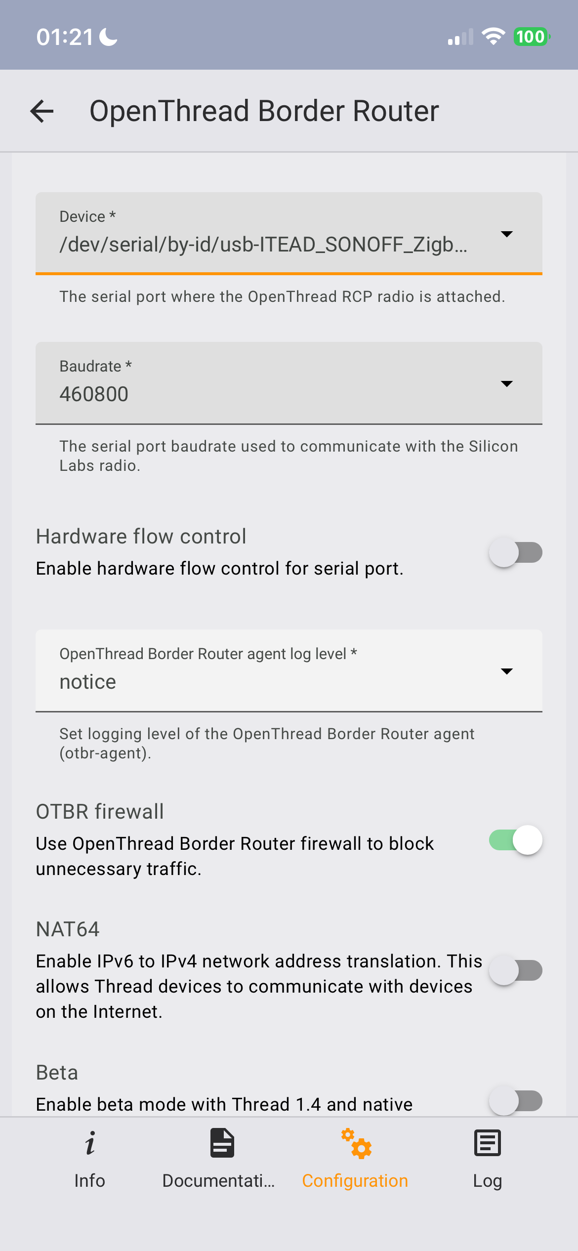

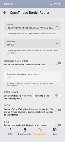

here are a few more pictures
I'm at a complete loss, Ive tried everything I can thing of but Im getting nowhere.

Any IPv6 networking issues? Are you logged in as an administrator account in HomeAssistant?
I think I’ve sussed it, there was some issue with the WiFi settings on my phones. I’m not 100% sure if it’s all working properly as I’ve had other things to do
I'll take a punt at DNS and IPv6. Common threads.
I would delete what is now a stale Thread 81eb (if it is still there).
For the 893c click on the 3-dots and select (something like) for use with iOS/Android. Then take one of your iPhones that you have not previoulsly done the "send credentials to phone" performed, and then perform the "send credentials to phone".
BTW, for your initial "Failed to save thread entwork credential error....does not match..." if you successfully commissioned a device and next time you get this error, just tap "continue" and commissioning should still work.
