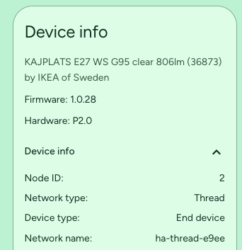

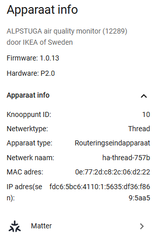

I bought 7 new IKEA Matter devices, only the Alpstuga shows up as routing end device.
The new bulbs named Kajplats show up as end device:

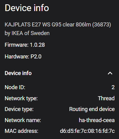

My KAJPLATS shows as a routing end device.
Very strange, looks like it is exactly the same bulb … the big one …
Correct, it’s the big one.

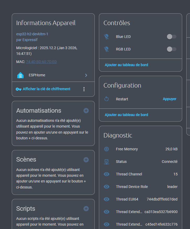

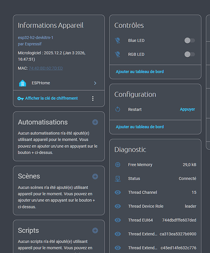

I forgot to mention earlier there are more affordable options for Thread range extension — a esp32-h2 or esp32-c6 devboard flashed with a basic esphome image can serve as a thread repeater node for as little as $5-10.

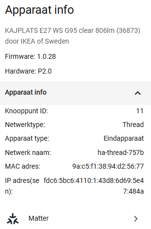

This is strange! Exact same bulb, I have to of them and both are listed as end device. I also have a 470lm version and that one is Routing end device, that one was added first.
FWIW, an ESP32 H2 (and I guess C6) with ESPHome make a router as well…
From my understanding, in Thread there is a device type called “FTD (Full Thread Device)” and although a FTD can be a router, it may start out as an End device and it will be up to another Thread node called the Thread “Leader” that will decide whether the FTD gets promoted to be a Router. So it is probably the case that the Leader promoted one bulb to be a Router, but not the other one.
This is my understanding too. From https://www.smarthomeperfected.com/thread/
Router-eligible End Devices (REEDs)
REEDs can serve as both end devices and routers, depending on the network’s needs.
When the network requires additional routers to improve connectivity or provide redundancy, a REED can upgrade itself to a full router role.
When functioning as an end device, a REED can communicate with other devices within the network and also route data if necessary. Examples of REEDs include smart light bulbs and smart plugs.
