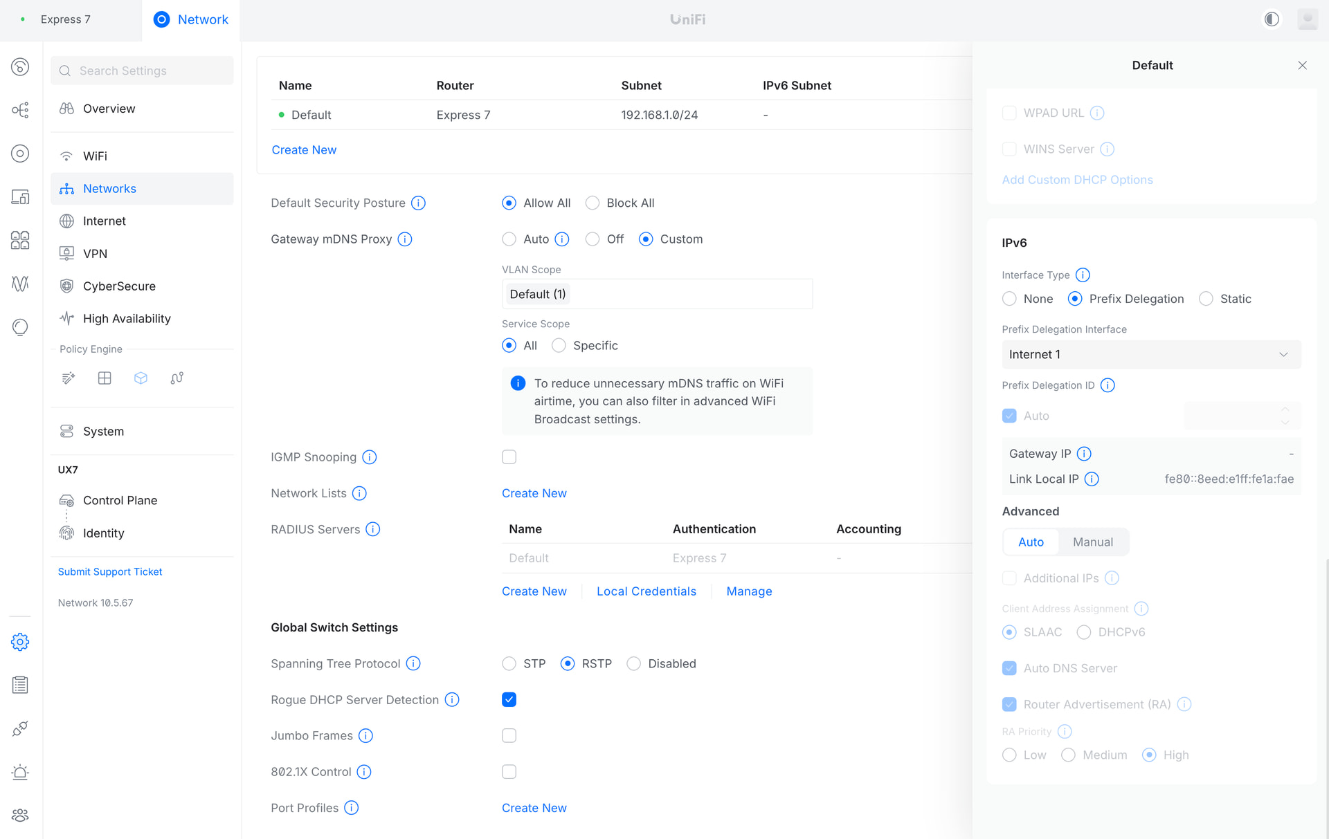

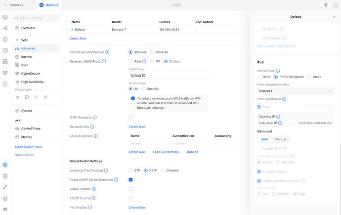

I have Unifi Express 7 for internet, I enabled mDNS and assume if it works since the Ultima’s mdns URL works: http://slzb-ultima3.local/. but don’t know if ipv6 is properly configured, refer to the images.

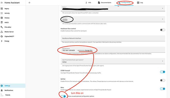

I believe the correct port to use is :6638 not 8080
after installing a boarder router i have often had to restart everything and then start the boarder router service.
You state that you are using 192.168.1.60:8080. The correct port to use for the OTBR app is 6638.
Me and my working SLZB on port: 6638…
I didn’t change the port, it says under the OTBR section that the port is 8080
you need to make these changes in home assistant:
how do I navigate to this? what version of HA is this?
home assistant running on Home Assistant Green.

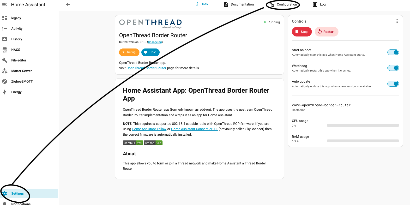

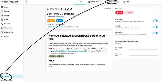

First thing, you need to have the app OpenThread Border Router installed.
When already installed goto SETTINGS > APPS > OpenThread Border Router > Configuration.
Otherwise install the app and follow the set up.
This is the offical setup to follow.

I got some help on Discord with the issue:
  • I don’t need to change the internet ipv6 configuration, that doesn’t do anything for local devices and again my ISP currently doesn’t support ipv6.

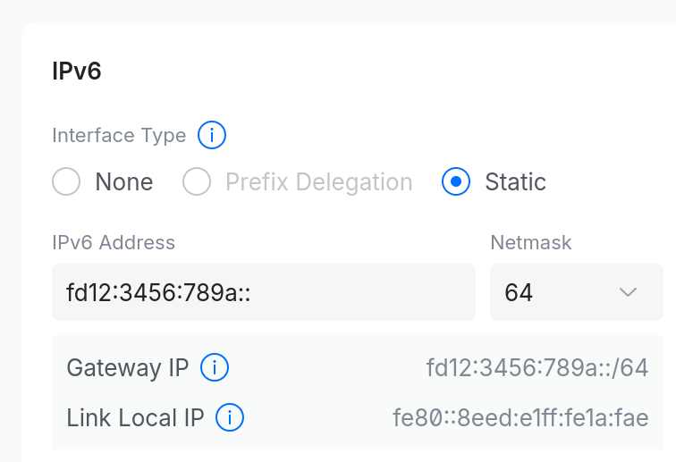

  • For the network configuration, I needed to change the ipv6 config to static and set a valid ULA prefix, I set it to fd12:3456:789a::.
