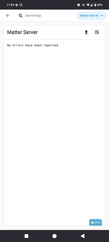

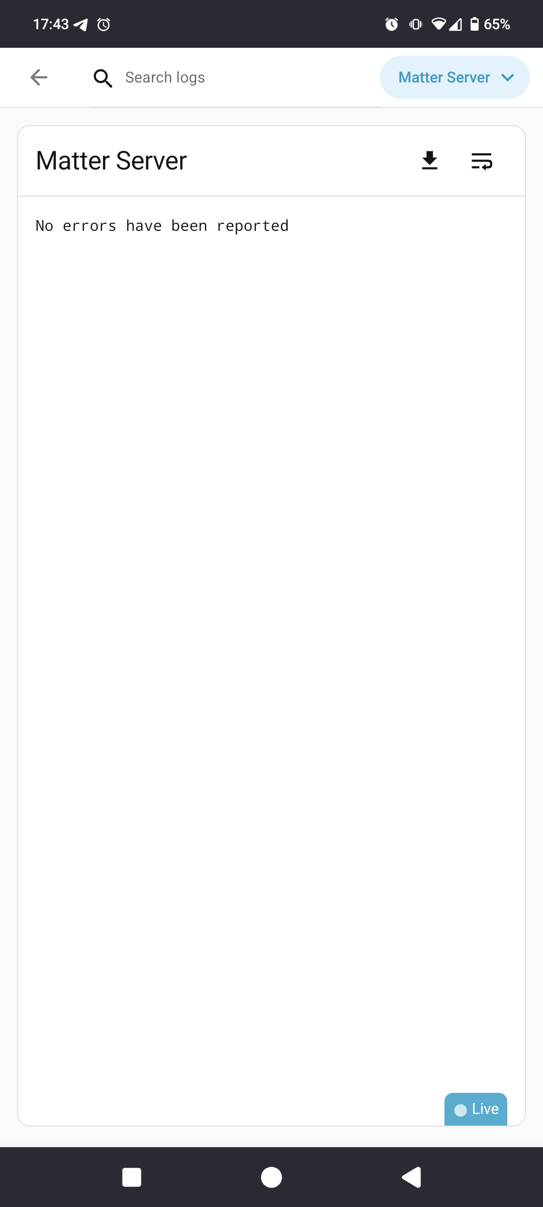

Where might I find some log about the pairing process? Maybe this will give some insight on what went wrong…
The Matter server addon has the logs.
The problem is that the addon seems to spew out warnings and errors all the time, so it can be a bit difficult to find the one that matter.
Go to the addon page instead
