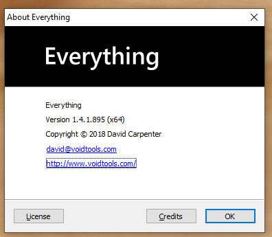

I use everything. A free tool for instant searches for files on your PC. I use it many times a day and strongly recommend using it on your PC. (I really wish there were a similar tool for Linux).
Install Everything and use it to search for “homeassistant.exe”. If it finds a file by that name then I would really like to know where on your disk was it found.

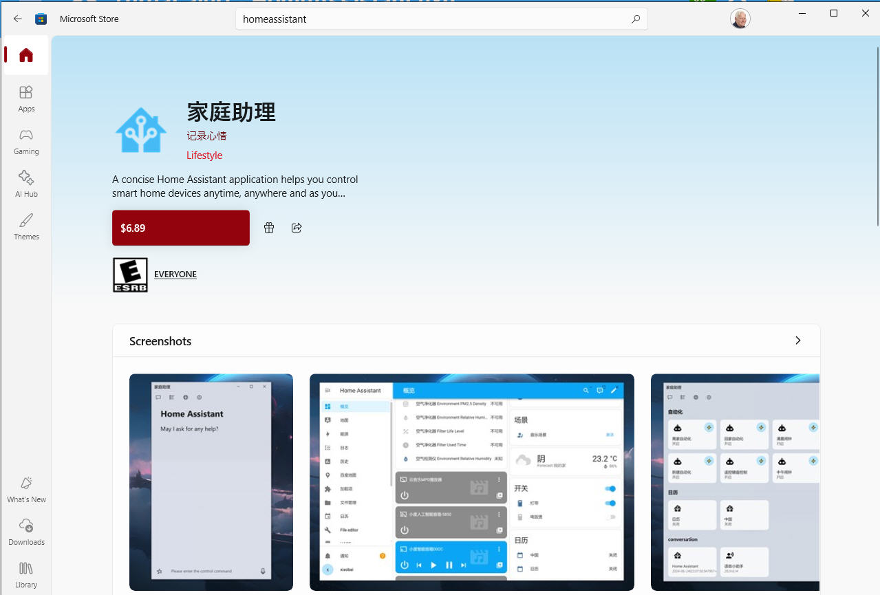

I used the Microsoft Store, Home Assistant Local.
This. Be very careful - because again there is no “Windows UI” to install. From Windows, everyone can just access HA via a(ny) web browser, and that’s the UI.
So if there is a Windows UI, in Microsoft Store, then (as you probably can tell from the reactions) that thing is not official / not from Home Assistant devs / not approved.
Do you have a screenshot of which one exactly? What kind of permissions this app would need?
Somebody else did it, and there is no guarantee what else would be inside the app. I would not ignore the thread alert and assume removing and reinstalling would solve the problem / the risk.

This is bad. Found on Microsoft Store
NOT
