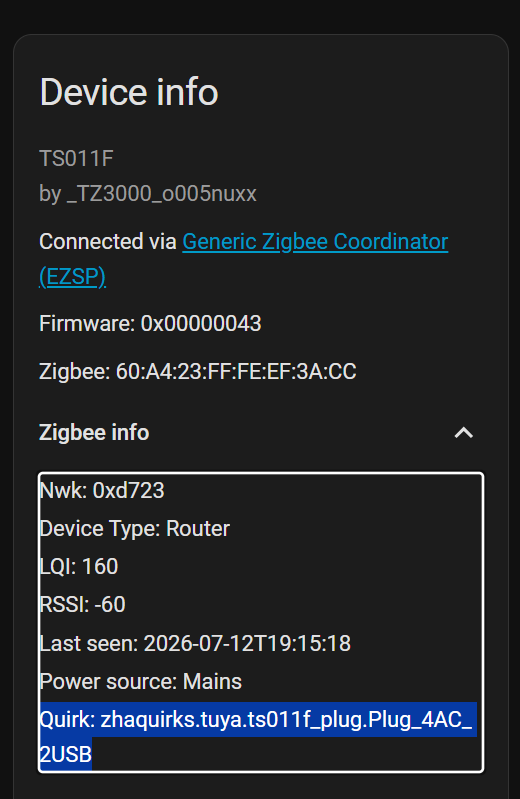

Easiest way to try & fix this is to attempt to reconfigure/re-pair your switch until you see it pick up the correct quirk. The below is just an example to show you where to look for it in the device page:

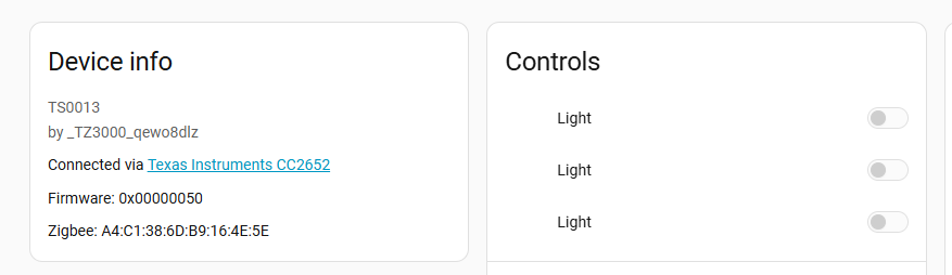

Here is an image from the old one.

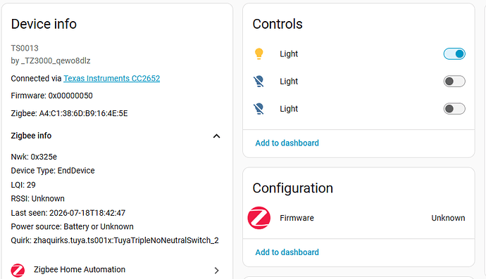

Not sure if I am the correct area. From Settings → Devices & Services → Zigbee
Here it is with the new set up.
Hope this is what you are looking for.

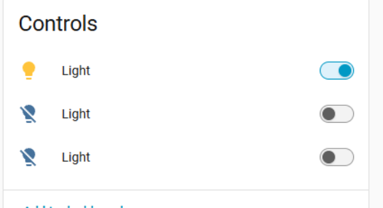

Yep, it seems to be picking up the correct quirk. Went down a rabbit hole trying to understand why your switch would behave like that & I think I understand what should be happening.
However, before I go on, can you confirm something? You said all lights turn on when you turn on a single switch, but your screenshot shows the correct status - only a single light is on in HA:
Are the other 2 lights turning on but not reporting their status to HA, or is it working correctly now?
Also, can you check whether the entity IDs are actually different by clicking on each bulb icon & clicking on the cog wheel icon on the top right of the popup? I find it strange that all 3 lights are named identically, but it’s not actually a problem if the entity IDs are different, like light.light, light.light_2 & light.light_3

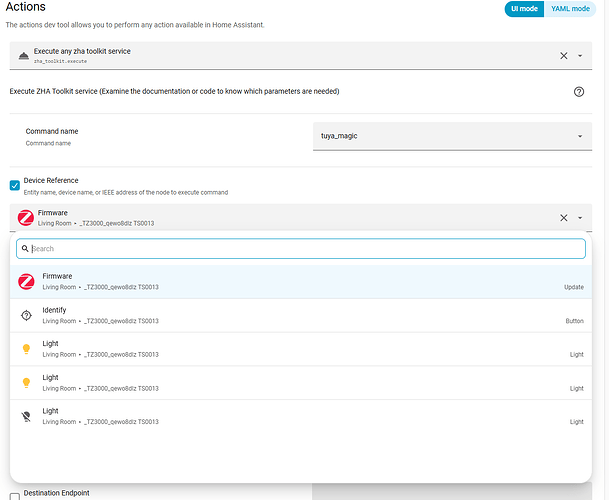

I finally have time to mess around with this. It took me a while, but I have ZHA Toolkit installed.
However, it seems the Github solution is a bit dated.
1. Install "ZHA Toolkit" - I did this via HACS
2. Go to "Developer Tools -> Services" in HA
3. Select Service "ZHA Toolkit: execute"

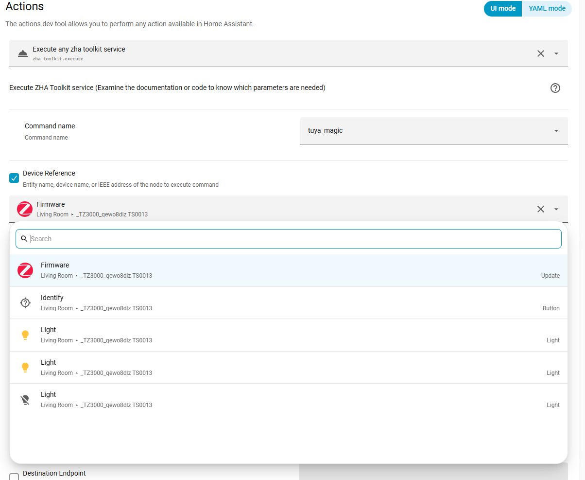

4. Select Command "tuya_magic"
5. In the ieee section select first Tuya entity and click call service - do for each Tuya entity
The “Services” is gone, but I figured out it is now “Actions.”
I am unsure about item #5. Click call service and do for each?
There is nothing to click except at the bottom labeled “Perform Action.”
That used to be “Call Service”.
I don’t think you actually need to perform the action for each entity, just once for the device.
Okay I got it. I had to restart HA to get it to connect again, but all switches are now operating independently. Thanks for your help (and to the others)!
