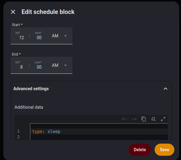

To do it with a Schedule helper, you can add data to each schedule block under the "Advanced Settings". That would look something like:
Doing it that way would simplify the Template sensor to something like:
template:
  - sensor:
      - name: HVAC Active Setpoint
        default_entity_id: sensor.hvac_active_setpoint
        unique_id: hvac_active_setpoint_0001
        state: |
          {% set type = state_attr('schedule.EXAMPLE', 'type') or 'unoccupied' %}
          {% set helper_id =  'input_number.' ~ type %}
          {{ states(helper_id) }}
