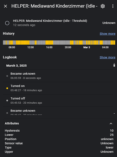

### PROBLEM DESCRIPTION
My Nous A1T smart plug, running Tasmota, restarts every …20 minutes due to an exception. This issue is causing my threshold sensors in Home Assistant to intermittently switch to "unknown" because the source sensor (connected to the smart plug) becomes unavailable during the restart.

* Set up a Nous A1T smart plug with the latest Tasmota firmware.
* Observe the device for approximately 20 minutes.
* The device will restart due to an exception, causing connected sensors to become unavailable.
### EXPECTED BEHAVIOUR
The smart plug should remain stable without restarting, and the connected sensors should maintain their status without switching to "unknown".
### SCREENSHOTS
nothing special to show
### ADDITIONAL CONTEXT
The issue seems to be tied to a recurring exception that forces the device to restart every 18-21 minutes. This behavior is consistent across multiple Nous A1T devices running Tasmota. The restarts are causing disruptions in my Home Assistant setup, particularly with threshold sensors that rely on data from the smart plug.
