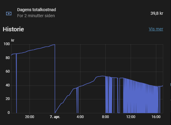

And you can clearly see in this screenshot how often and what time of day this happens. This is from today:
