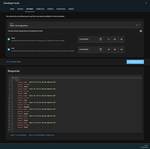

I reloaded all sensors from this post
But my problem goes on.
Than I reloaded 1 sensor with an action and after that I see in the logs

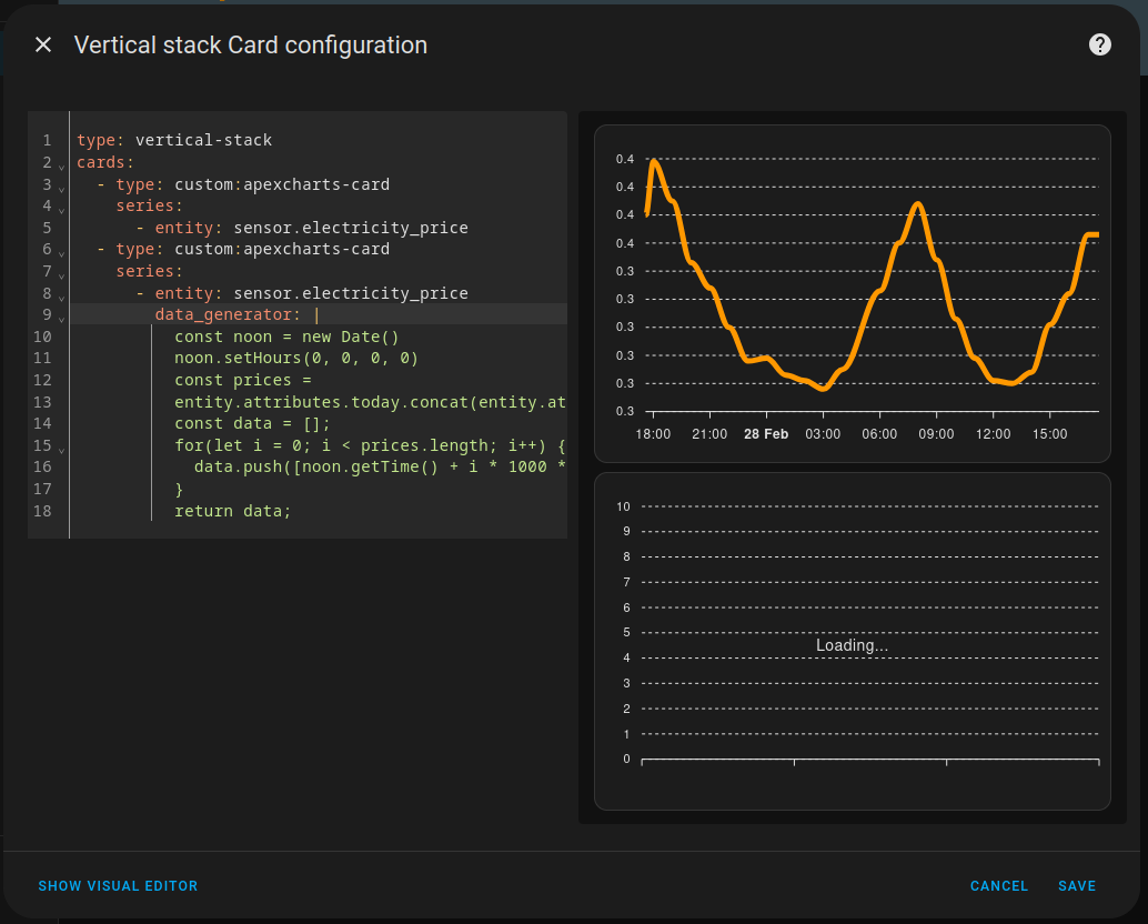

For some reason I don’t get data via the data_generator. Tried with this solution as well as other and always get stuck in “Loading…”. Any advice?
PS: Missed to add the REST sensor. Sorry for the noise.
seeing the complete code might help…
so for me the code in the screenshot is cut off…
You won’t be able to generate a curve with this data_generator: code!
In your screenshot above, the code goes up to line 18 but is unfortunately cut off on the right!

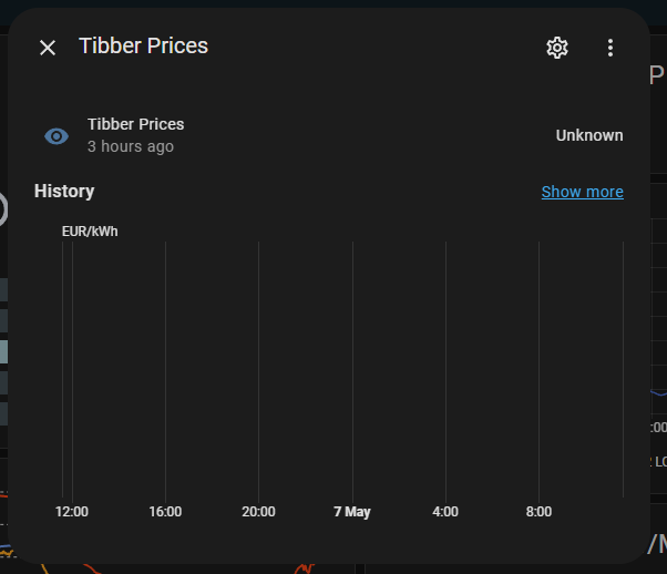

Hi @KlausB and @ingo.niehues , same question/issue:
  • sensor.tibber_verbrauch_daily/weekly/monthly/yearly are these 4 created utility meters with the total consumption set (one for daily, one for weekly, one for monthly and one for yearly)?
  • how can I create the daily, weekly, monthly and yearly costs per kwh?
    When I try toss-up a template helper sensor and put in the code:
{{ (states(“sensor.tibber_kosten_daily”) | float(default=0) / states(“sensor.tibber_verbrauch_daily”) | float(default=0) * 100) | float(default=0) }}
where can I retrieve the “sensor.tibber_kosten_daily” (I added the tibber example prices tibber_prices rest api to my configuration.yaml)?
Thanks so much for the code, unfortunately I spend way too many hours trying to make it work (each restart take times), but the entity always stay at “Unknown”
I did add the code in configuration.yaml, like so
sensor:
  • platform: rest
    unique_id: tibber_prices
    resource: https://api.tibber.com/v1-beta/gql
    method: POST
    payload: ‘{ “query”: “{ viewer { homes { currentSubscription { status priceInfo { current { total level } today { total level } tomorrow { total level } } } } } }” }’
    json_attributes_path: “$.data.viewer.homes[0].currentSubscription.priceInfo”
    json_attributes:
    • today
    • tomorrow
      value_template: “{{ value_json.data.viewer.homes[0].currentSubscription.priceInfo.current.total | float }}”
      scan_interval: 30
      headers:
      Authorization: !secret tibber_token
      Content-Type: application/json
      User-Agent: REST
      unit_of_measurement: EUR/kWh
and I did add the tibber_token: in secrets.yaml
In the logs I have:
Logger: homeassistant.components.rest.data
Source: components/rest/data.py:114
integration: RESTful (documentation, issues)
First occurred: 6 May 2025 at 20:16:53 (7 occurrences)
Last logged: 08:15:53
Timeout while fetching data: https://api.tibber.com/v1-beta/gql
Logger: homeassistant.components.rest.util
Source: components/rest/util.py:18
Empty reply found when expecting JSON data
Source: components/rest/util.py:37
First occurred: 6 May 2025 at 15:51:41 (253 occurrences)
Last logged: 10:44:43
REST result could not be parsed as JSON
Source: components/rest/util.py:33
First occurred: 6 May 2025 at 15:51:41 (6727 occurrences)
Last logged: 11:15:43
JSON result was not a dictionary or list with 0th element a dictionary
This tibber code is the only thing in my HA trying to use rest.
Otherwise the official Tibber integration is working and fetching the data, I could even successfully get manually the forecast with the action tibber.get_prices
Could someone please help? It would be so amazing and saving me money, if I could have the forecast in HA

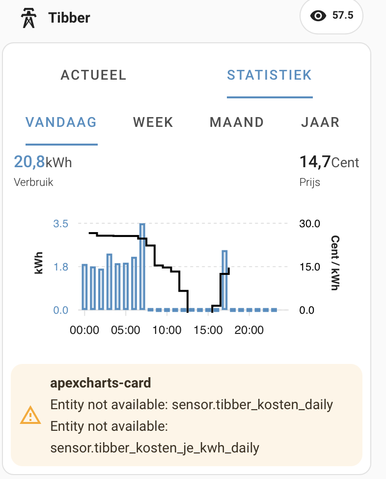

I got the basics working but 3 sensors are missing:
  • sensor.tibber_aktueller_Prijs_ist_tageshochstPrijs
  • sensor.tibber_kosten_daily
  • sensor.tibber_kosten_je_kwh_daily
Anyone got ay ideas how to create them?

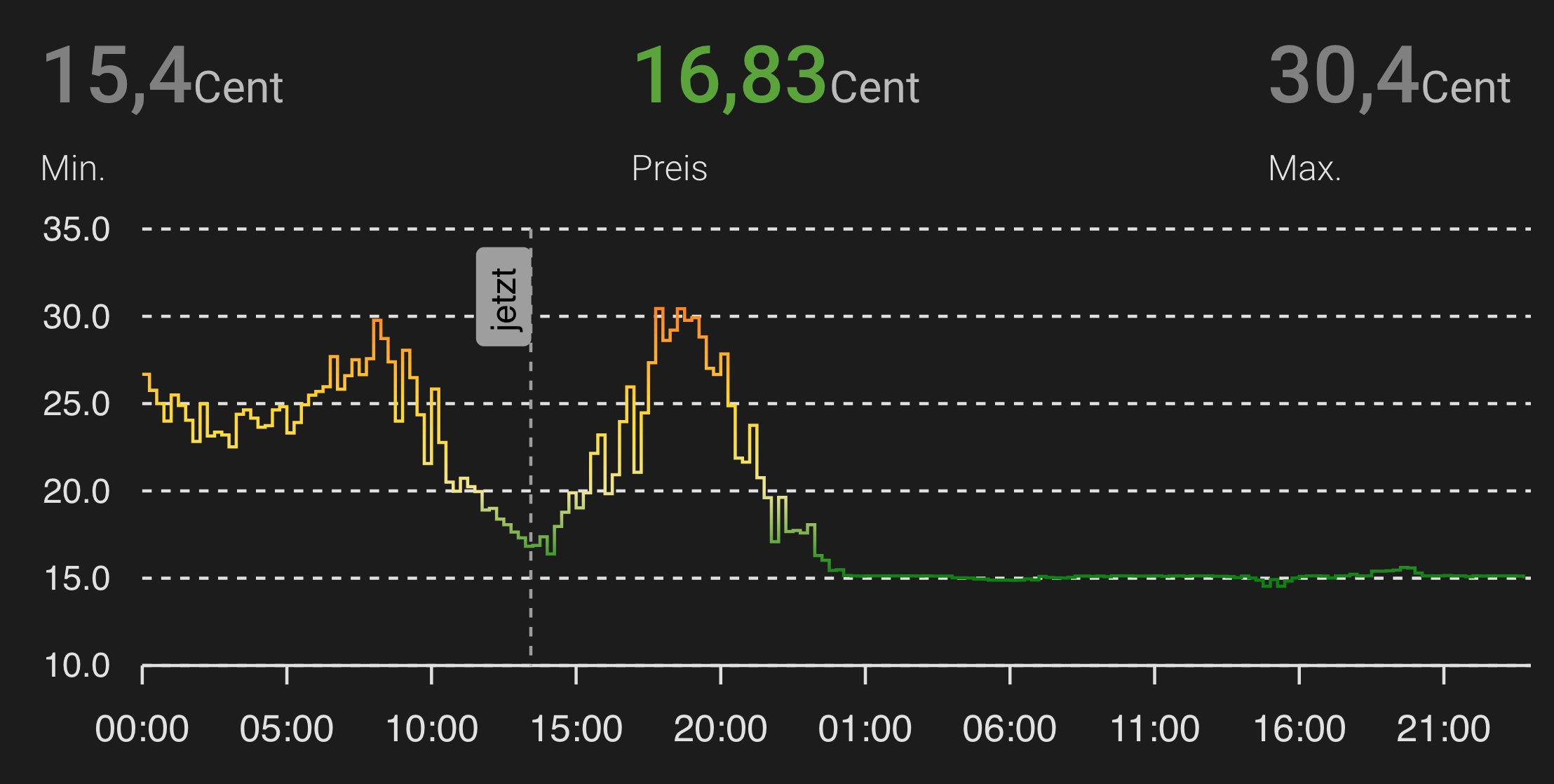

Based on Ingos Charts, i created a chart for a 15 min Interval
type: custom:apexcharts-card
experimental:
  color_threshold: true
all_series_config:
  unit: Cent/kWh
apex_config:
  grid:
    show: true
    borderColor: "#E0E0E0"
  chart:
    height: 200px
    offsetY: -20
  tooltip:
    enabled: true
    followCursor: false
    x:
      show: false
    fixed:
      enabled: true
  xaxis:
    type: datetime
    labels:
      format: HH:mm
      datetimeFormatter:
        hour: HH:mm
        day: HH:mm
    tickAmount: 8
    tooltip:
      enabled: false
header:
  show: true
  show_states: true
  colorize_states: true
  standard_format: false
graph_span: 48h
now:
  show: true
  color: 9E9E9E
  label: jetzt
span:
  start: day
series:
  - entity: sensor.fredenbeck_strompreis
    attribute: min_price
    unit: Cent
    transform: return x * 100;
    show:
      in_header: true
      name_in_header: true
      in_chart: false
    color: grey
  - entity: sensor.tibber_prices_quarterly
    unit: Cent
    show:
      in_header: before_now
      header_color_threshold: true
    color_threshold:
      - value: 0
        color: lime
      - value: 15
        color: green
      - value: 20
        color: Khaki
      - value: 25
        color: Gold
      - value: 30
        color: darkorange
      - value: 35
        color: orangered
      - value: 40
        color: red
    type: line
    curve: stepline
    extend_to: false
    stroke_width: 1.5
    float_precision: 2
    data_generator: |
      // Stellt sicher, dass fehlende Attribute zu leeren Arrays werden
      const today = entity.attributes.today || [];
      const tomorrow = entity.attributes.tomorrow || [];
      const prices = today.concat(tomorrow);
      const noon = new Date();
      noon.setHours(0, 0, 0, 0);
      const data = [];
      const interval_seconds = 900; // 15 Minuten
      for(let i = 0; i < prices.length; i++) {
        data.push([noon.getTime() + i * 1000 * interval_seconds, prices[i].total * 100])
      return data;
    attribute: max_price
    unit: Cent
    show:
      in_header: true
      in_chart: false
    color: grey
  # Tibber Vorschaupreise 15 Minuten
  - platform: rest
    unique_id: Tibber Prices Quarterly
    name: Tibber Prices Quarterly
    method: POST
    payload: '{ "query": "{ viewer { homes { currentSubscription { status priceInfo(resolution: QUARTER_HOURLY) { current { total level } today { total level } tomorrow { total level } } } } } }" }'
    json_attributes_path: "$.data.viewer.homes[0].currentSubscription.priceInfo"
    json_attributes:
      - today
      - tomorrow
    value_template: "{{ value_json.data.viewer.homes[0].currentSubscription.priceInfo.current.total | float }}"
    scan_interval: 30
    headers:
      User-Agent: REST
Does this make sense? The prices change a 0:00 from today->tomorrow and we get tomorrow’s prices by 13:00. I would not poll prices every 30 seconds! (even every 3600 seconds=hourly is overkill)
