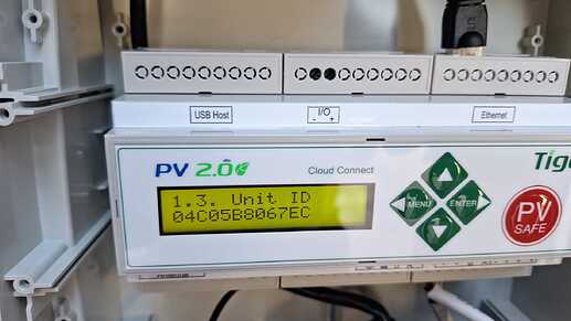

@Smanny May I ask how old (years?) is your installation?
Can you please share HW and FW versions of your components?
I am asking, because:
  • As the white CCA you use seems to be predecessor of the green CCA - at least I did not find any current reference to your device
  • the messages you recorded seems to be for older GW and nodes (star topology vs new mesh topology)
@litinoveweedle year 2013

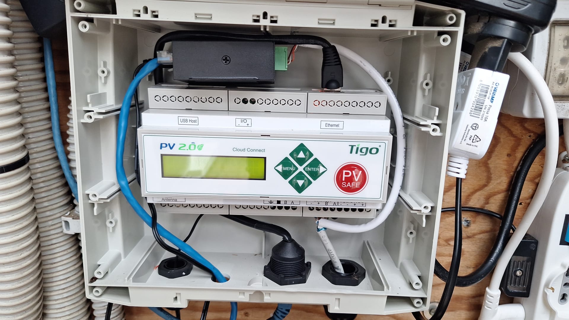

I took some pics before installing the waveshare:

Thank you. So it seems that your installations is not a probably never be supported, as it uses old version of the communication protocol, which is not implemented in the taptap. I am sorry.
