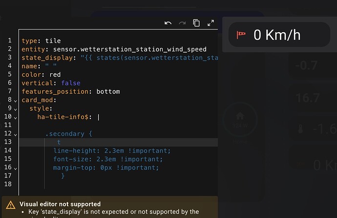

Can anybody explain the feature of „t“ here.
Btw. This works with any character.
This makes exactly what I need. It brings the text in the middle.

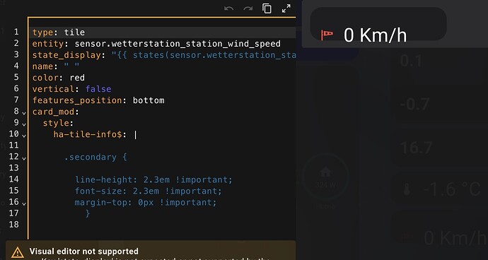

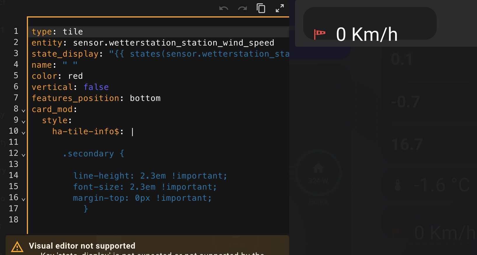

type: tile
entity: sensor.wetterstation_station_wind_speed
state_display: "{{ states(sensor.wetterstation_station_wind_speed) }}"
color: red
vertical: false
features_position: bottom
card_mod:
  style:
    ha-tile-info$: |
      .secondary {
        t
        line-height: 2.3em !important;
        font-size: 2.3em !important;
        margin-top: 0px !important;

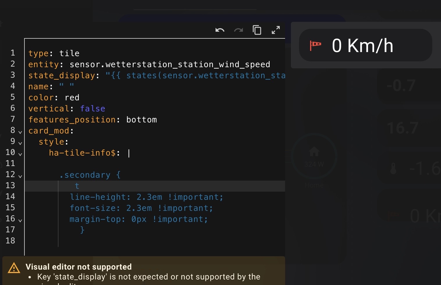

Seems that this makes the “line-height: 123;” to “t line-height:123;” - thus the property is ignored.
Check in Code Inspector if the “line-height” is set.
Oh crazy, yes the t ignores the next line. Which is fault. I do not know how this came in.
