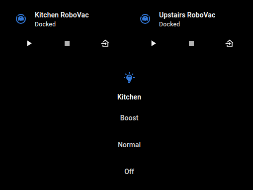

I’m using the following code for a tile card that will have 3 buttons using features → buttons
            - type: tile
              entity: "script.light_controls"
              hide_state: true
              icon: "mdi:lightbulb"
              icon_tap_action:
                action: "none"
              features:
                - type: "button"
                  action_name: "Boost"
                    entity: "light.group_kitchen_lights"
                    action: "boost"
                - type: "button"
                  action_name: "Normal"
                    action: "normal"
                - type: "button"
                  action_name: "Off"
                    action: "off"
              tap_action:
                action: "none"
              vertical: true
This works, but created the buttons vertically as you’ll see in the screenshot for the card ‘Kitchen’
Ideally though, the buttons would be horizontally like they are in the vacuum card have, which is why I included them in the screenshot
Has anyone managed to do this?

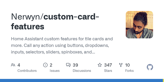

I manage to do this but using custom feature from HACS:
There is not (yet?) the possibility in core to do a row of buttons.
