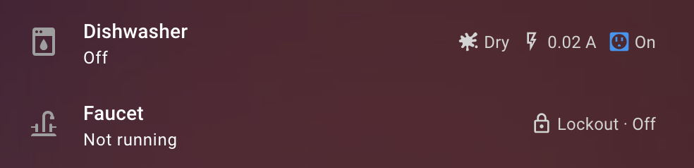

Hi all - Please find below an extension to the Tile Card with the Badges behaviour from the Heading card. I have set the behaviour to follow the ‘features position’ - if the feature is inline, then the badges will be placed inline with the state, if the features are set to bottom, then the badges will be in the position of the inline feature. For my purposes, this provides a significant improvement to the Tile Card, allowing an ideal density of information/capability. The card was written to be a ‘patch’ to the Tile Card and reuses as much of the two as possible, including the visual UI. I would be happy to submit this as a PR for the Tile Card, if it was something the community would welcome.
You can use the JS file from the link below placed in your www folder to use this card. Any feedback welcome.

Thanks @Mariusthvdb - The Yaml is 1-to-1 with the Tile Card + the Badges entry matching the Headings card. Here are two examples:
Dishwasher (no features, badges in feature position):
type: custom:inline-badge-tile-card
entity: sensor.dishwasher_machine_state
vertical: false
features_position: bottom
badges:
  - type: entity
    show_state: true
    show_icon: true
    entity: binary_sensor.dishwasher_leak_sensor_water_leak
    color: state
    icon: mdi:liquid-spot
  - type: entity
    show_state: true
    show_icon: true
    entity: sensor.dishwasher_outlet_current
    color: state
    icon: mdi:flash-outline
  - type: entity
    show_state: true
    show_icon: true
    entity: switch.dishwasher_outlet
    icon: mdi:power-socket-us
    color: blue
    tap_action:
      action: more-info
grid_options:
  columns: full

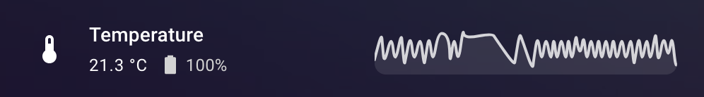

Ceiling Fan (Fan speed feature, badges next to State):
grid_options:
  columns: full
entity: fan.esp32_rf_transceiver_rf_fan
vertical: false
features:
  - type: fan-speed
features_position: inline
badges:
  - type: entity
    show_state: true
    show_icon: true
    entity: switch.master_master_ceiling_fan_fan_reverse
    color: state
    icon: mdi:rotate-left
    tap_action:
      action: toggle
  - type: entity
    show_state: true
    show_icon: true
    entity: switch.esp32_rf_transceiver_override_remote
    tap_action:
      action: toggle
    color: state

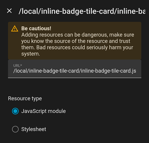

Where do I have to put the JS-File? Tried it directly in the www-folder and with a subfolder named „inline-badge-tile-card“ inside the www-folder.
I get the error „Custom element doesn’t exist: inline-badge-tile-card“.
@ComputerZOO Hmm, it should go in the www folder directly as you had done. There shouldn’t be anything further needed, except a ‘quick restart’.
I got it working with a few CTRL F5 and adding it to the Resources panel
