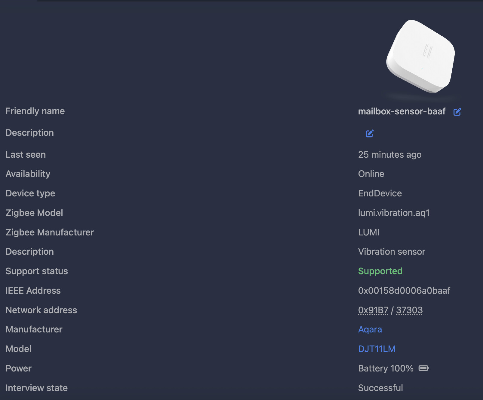

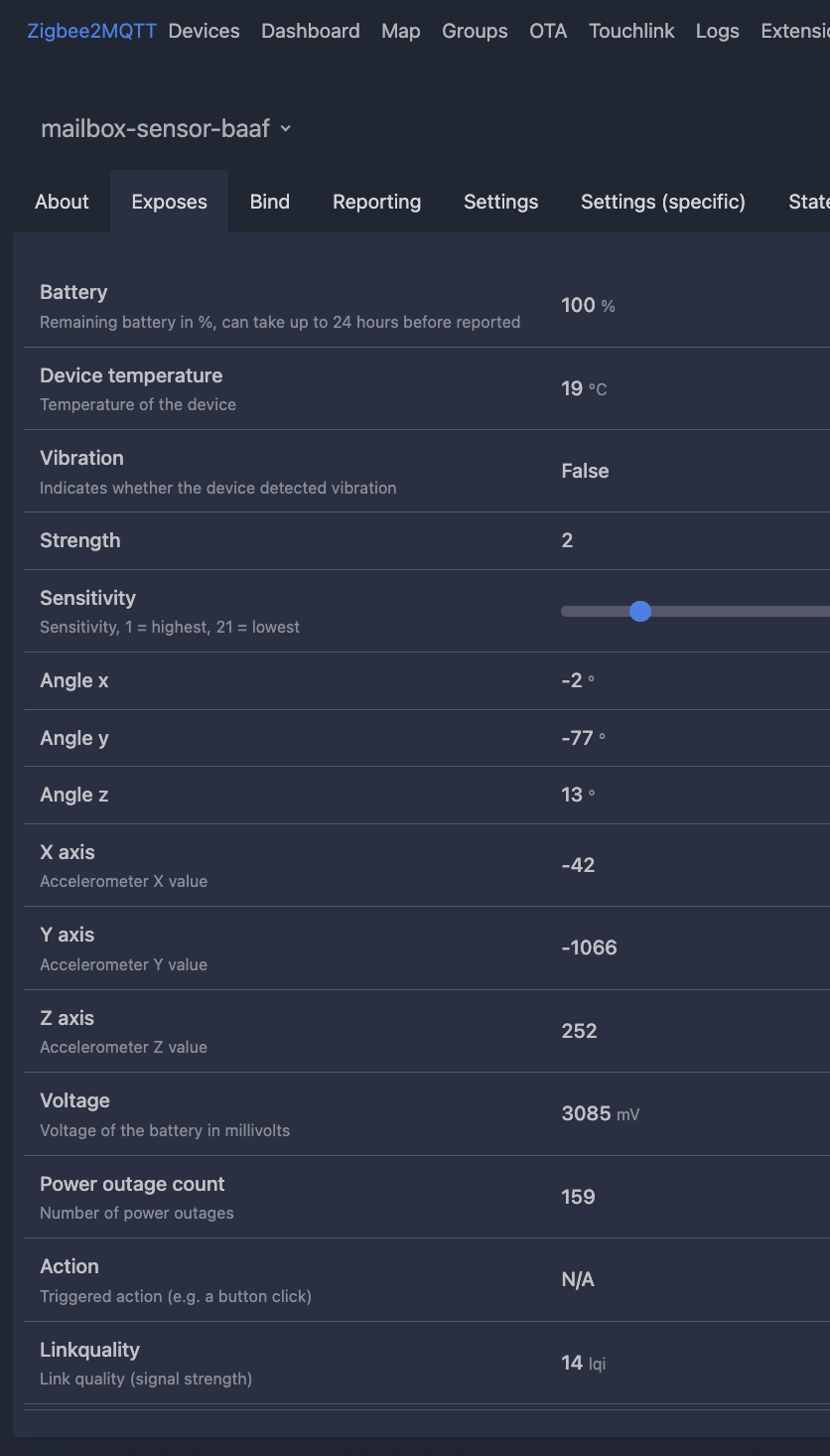

I’ve had good success with this zigbee device detecting the mailbox door opening and closing. You can probably get it for lower price on aliexpress (or maybe those were the old days :unamused:). It has adjustable sensitivity, good to have as I found it detects birds landing on the mailbox :hatched_chick::mailbox_with_mail:. As a plus it reports temperature once an hour, if nothing else this works as kind of ‘watchdog’ for the device in operation :dog2:.

I should have been more specific about my setup. I use Zigbee2MQTT for my Zigbee devices. After using both Zigbee2MQTT and HA’s native Zigbee solution, I have found Zigbee2MQTT far more capable. Good hunting.
