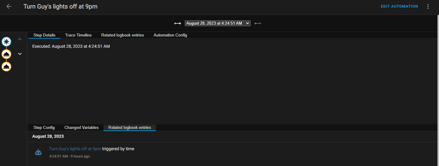

I’m using HA on an arch linux machine, and yesterday after a power outage I restarted the device and all my time-based automations have started activating at the wrong times. However, the system clock is correct and HA even reports that the time based trigger was at the wrong time, so I don’t understand why it would trigger it. To clarify that last statement, here’s a trace from one such automation:
It reports that this happened at 4:24am despite the config clearly indicating it should happen at 9pm. It’s weird that it isn’t even a time zone error, because then it’d be exactly n hours off. And yes, I can confirm 100% that this was not me manually running the automation tasks, as evidenced by the logbook entries:
(If it was manually triggered, it’d say the node wasn’t tracked).
