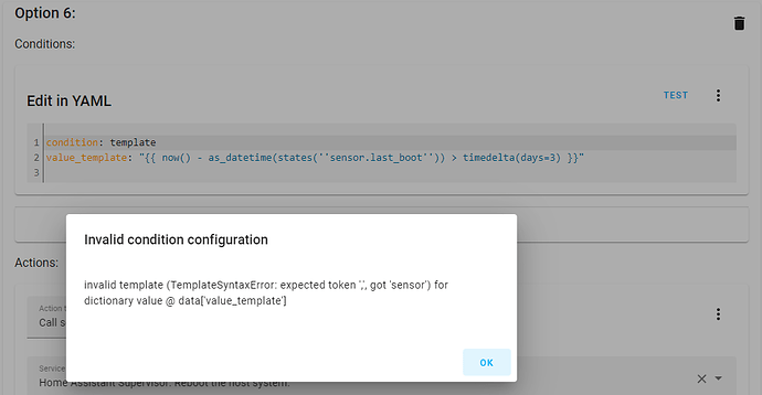

Quick question:
I’m putting this inside an “option” on the actions and I’m getting the following error:

It works in the template editor and I just double checked it by pasting it into my config and running a configuration check, which passed.
I think the issue is you have double ‘’ around sensor.last_boot - believe if you use " to surround then you’d need single ’ and if you use single ’ to surround, then you’d use double ‘’ inside.
