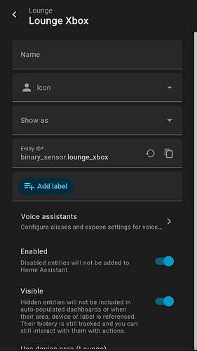

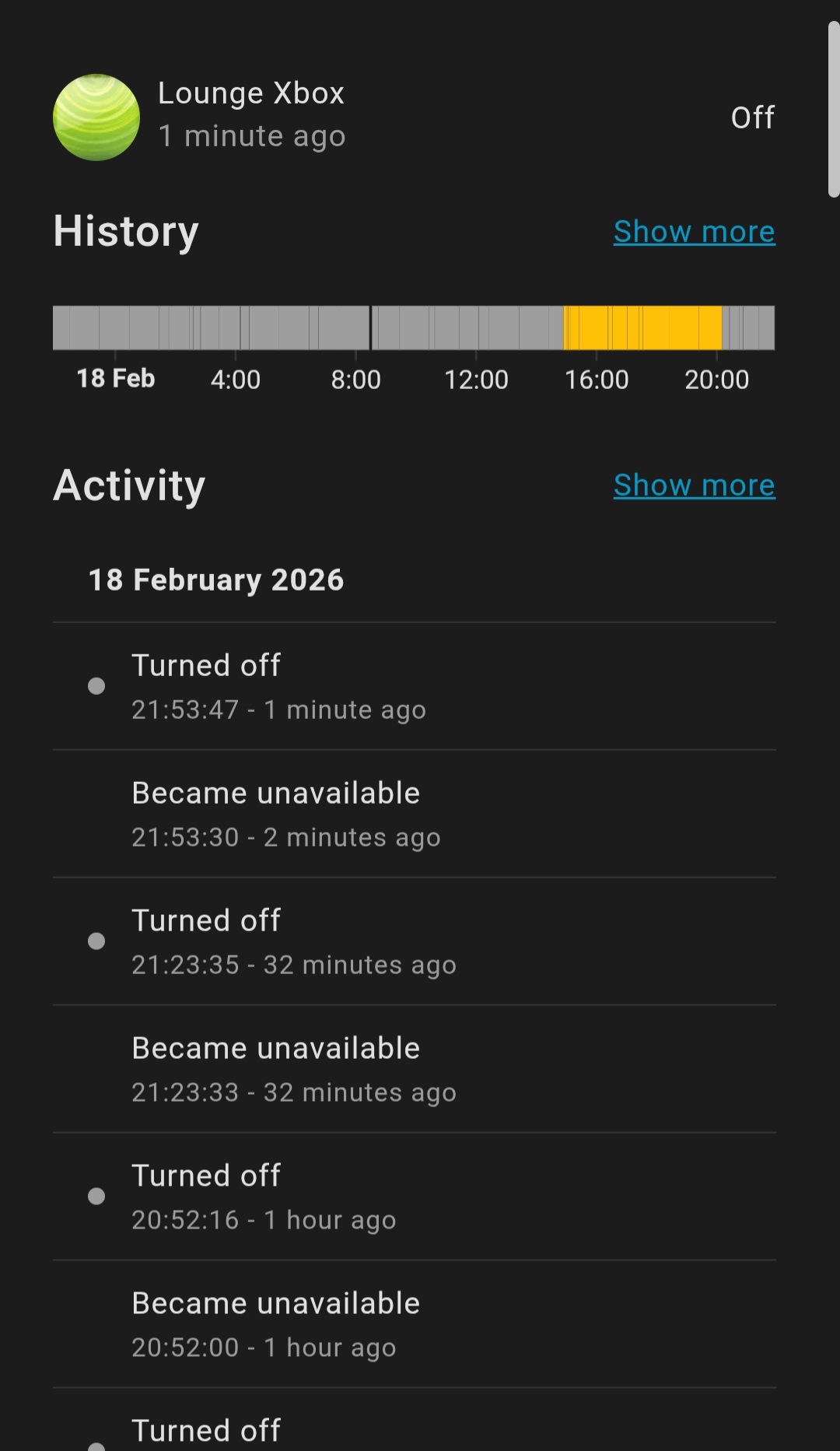

I have thr xbox integrated in to HS, amd there is a entity for its power as below.
Could a sensor be linked to this to calculate the amount of time it been in its “on” state. The turn it off via that entity?

Yes, not a big deal to set up a helper that counts uptime of the entity. But check the device page. What other entities does it expose?
