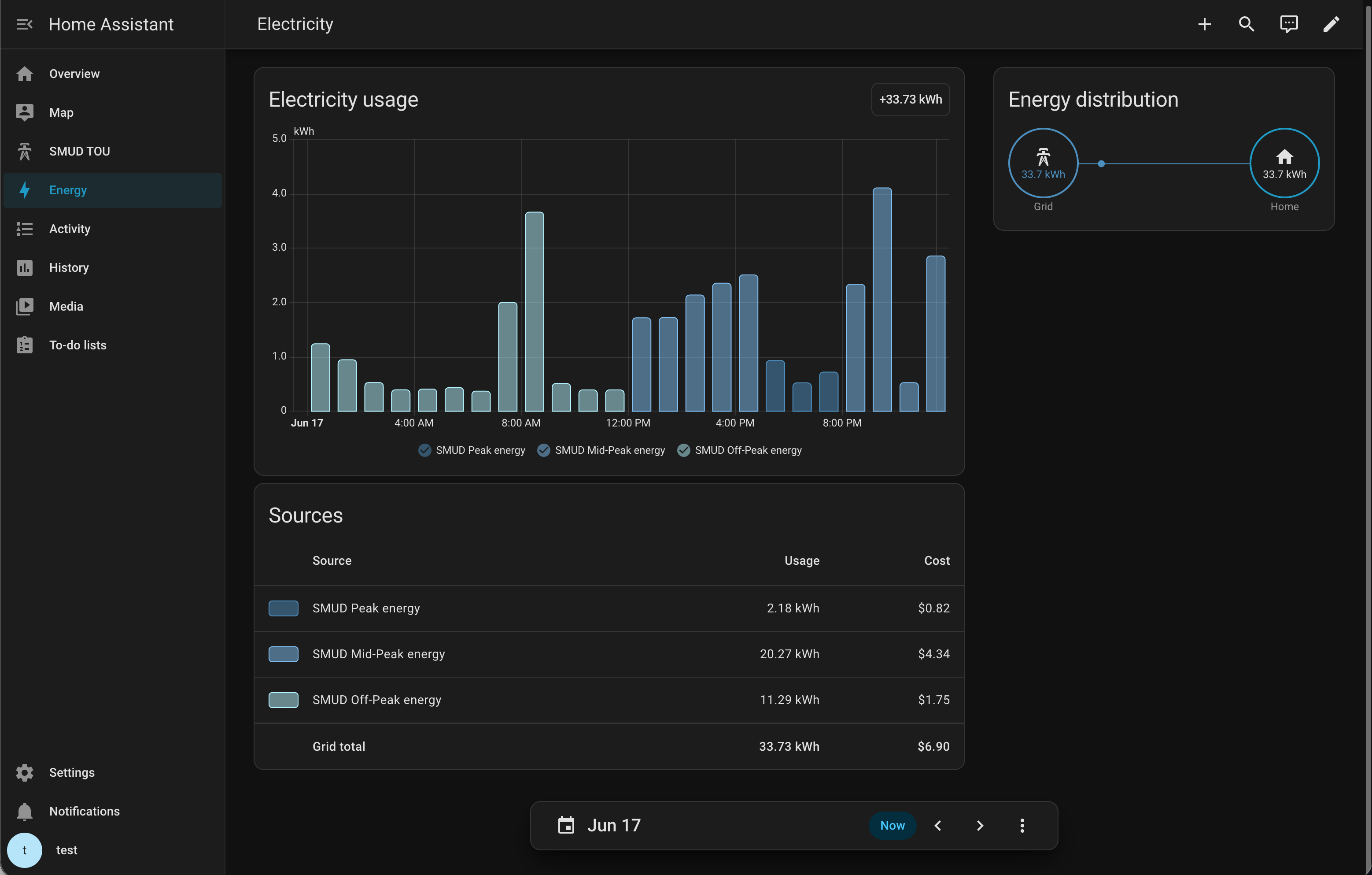

Here’s what it looks like with the parsed data feeding the Energy dashboard, each TOU period as its own grid source with its own cost (this is a real day from my meter):

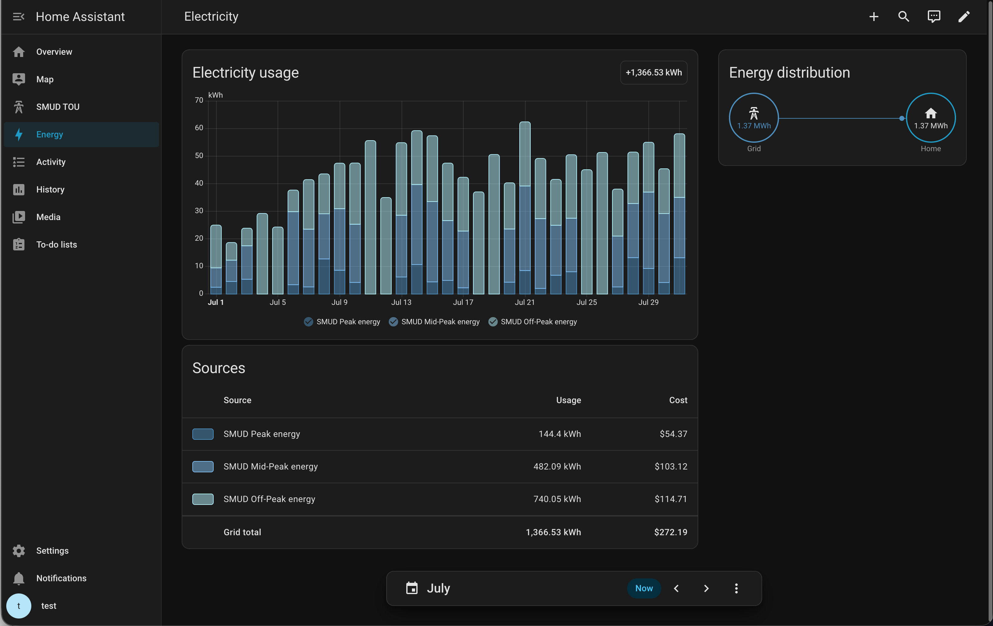

And a full month :sweat_smile:
