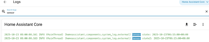

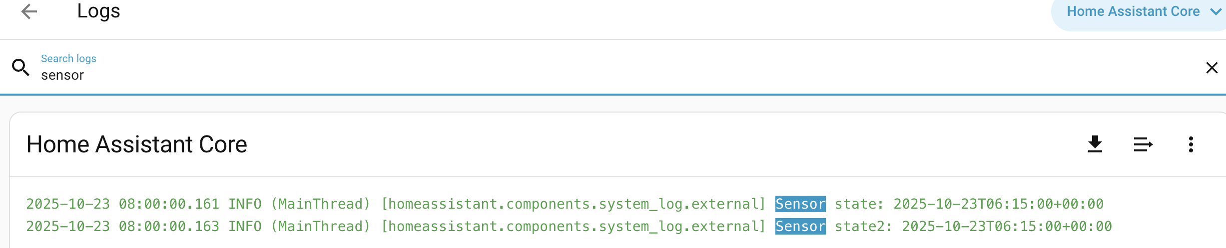

I created an extra automation that logs the current sensor value at 8am. Today it logged 6:15 (8:15, UTC+2):
So this way I know the phone sends correct data to HA.

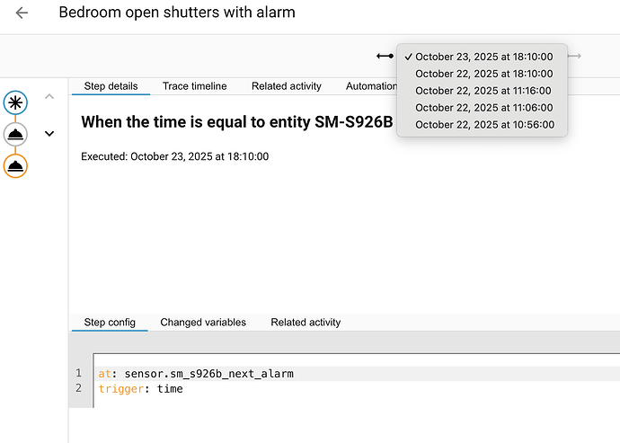

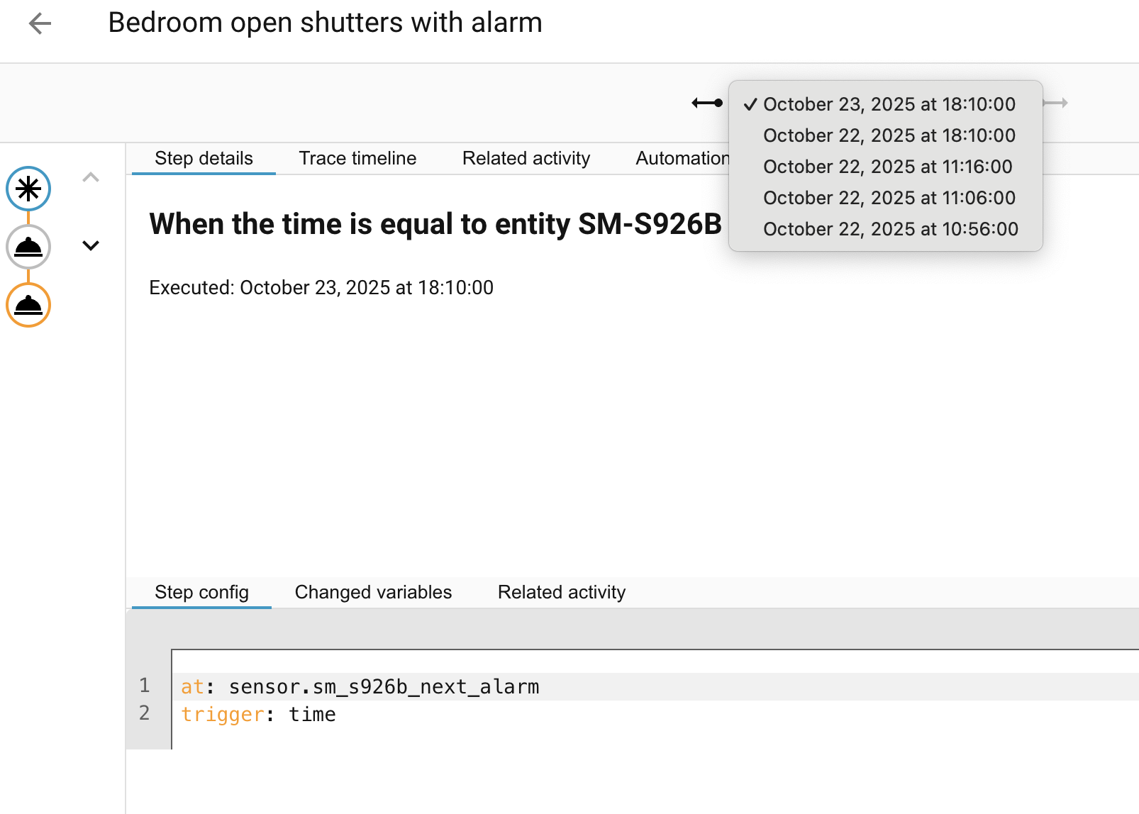

I looked at the automation trace and there was no trigger for today morning, only my evening alarm. You can even see 10-minute snoozes on 22nd triggered correctly:
I have ruled out TZ issue as this works most days.

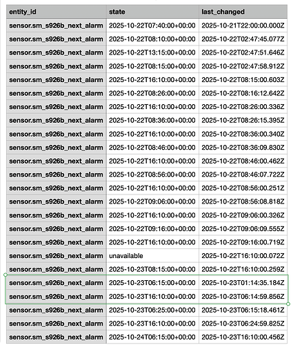

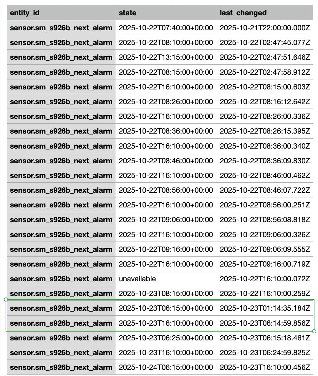

Share the history of sensor.sm_s926b_next_alarm during that time. That would be the only reason it doesn’t trigger.
@petro Thanks for the idea. I think this shows a problem. And my hypotheses this is a concurrency issue:
  1. Sensor value is set to 8:15 at 3:14am on 23rd
  2. At 8:15 alarm rings and HA should execute the automation
  • This does not happen because phone updates the sensor value at 8:14:59.56 to the next alarm at 18:10, probably due to current alarm starting and thus becoming obsolete
  1. After 18 seconds of ringing, I snooze the alarm and the sensor value is updated to 8:25 (+10min snooze)
  2. After 10 minutes I kill snoozed alarm and the sensor value is updated to the next evening alarm 18:10
  • the 144ms premature setting happens here as well, that is why the snoozed alarm did not raise the cover too
  1. Evening alarm at 18:10 sets the sensor value to 8:15 correctly, this time 456ms after the alarm time
I will think about some workaround, but I think the reporting from interface between companion app and phone should never update time sensors early, possibly introduce some minor delay.
