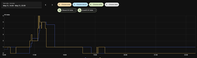

Same thing here. I tried filtering the UV index to get rid of some weird, sometimes extreme 1-minute peaks that are obviously wrong:
- platform: filter
name: "Filtered UV Index"
unique_id: filtered_uv_index
entity_id: sensor.ecowitt_uv_index
filters:
- filter: time_simple_moving_average
window_size: "00:03"
precision: 0
This is what I get:
Simply does not return to zero no matter how long I wait. Only reloading all YAML config forces the sensor to update and it snaps back to where it should be.
Problem seems to be that this sensor I want to filter only updates upon change and the filter only seems to recalculate when it gets a new input - no matter how old that last input is!
…I too would consider this a bug, but I’m no expert.
Another “simple time moving average” filter that has an underlying sensor that constantly updates works perfectly fine.
Any ideas / solutions anyone?
