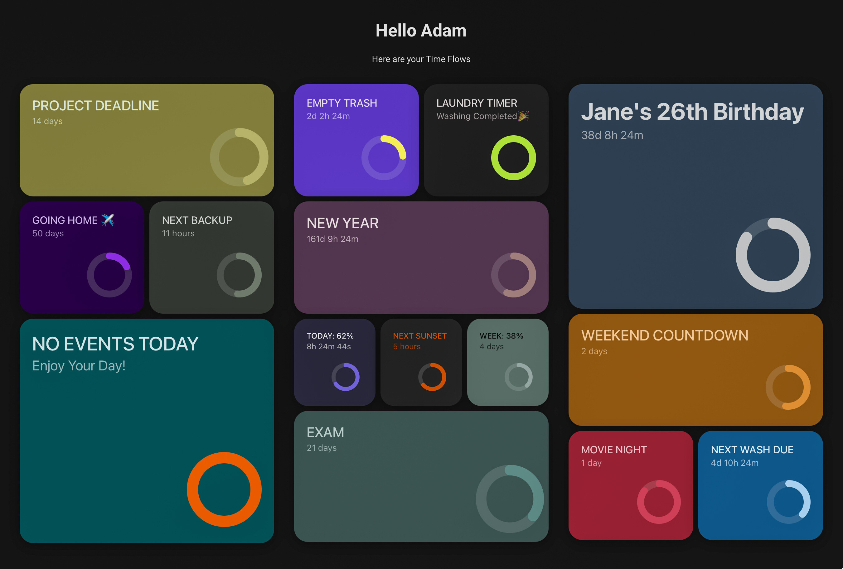

I’m excited to share a card I’ve been working on that brings beautiful countdown timers to Home Assistant: :alarm_clock: TimeFlow Card
A beautiful countdown timer for Home Assistant that features animated progress circles and smart, easy-to-read time formatting. Whether you’re tracking birthdays, deadlines, events, or anniversaries, this card makes it look great and keeps you updated in real time! :alarm_clock:
:wrench: Features
  • :bullseye: Entity Support for dynamic countdowns from sensors
  • :high_voltage: Real-time updates with 1-second precision
  • :brain: Smart Time Display with natural language formatting
  • :performing_arts: Fully customizable colors, sizes, and time units
  • :rainbow: Template Support for dynamic content and colors
:bullseye: Use Cases
  • Project deadlines and milestones
  • Event countdowns (birthdays, vacations, holidays)
  • Maintenance schedules (backups, updates, renewals)
  • Goal timelines (exams, competitions, launches)
  • Server monitoring and automation tracking
:light_bulb: Why TimeFlow Card?
The idea behind TimeFlow Card is to bring an elegant and animated way to visualize time-based events right on your Home Assistant dashboard something more expressive than plain numbers or static countdowns.
The visual design takes inspiration from modern iOS-style widgets and minimal dashboard aesthetics, focusing on smooth animations, intuitive layouts, and clean typography.
But what makes TimeFlow Card different?
  • Other countdown cards show time in just numbers — TimeFlow Card shows progress visually through animated rings and smart formatting.
  • It’s perfect for users who want a sleek, no-fuss way to track events like meetings, trips, or routines.
  • The card supports full customization through YAML, but also works out-of-the-box with default styles if you prefer simplicity.
  • The card supports Homeassistant Templates for all the important configs so it is heavliy customizable.
TimeFlow Card is still evolving, so you can expect improvements and possibly a few breaking changes as new features roll out. If you enjoy visual dashboards and care about how time is displayed, give it a try!
:rocket: Ready to try it?
You can install TimeFlow Card easily via HACS by searching for TimeFlow Card under the Frontend section.
I’d love to hear your feedback or ideas to make it even better! :hugs:
