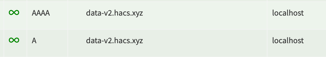

After HA was once again online, I verified in Pi-hole that queries using DNS (such as a reload of the HACS integration) were showing up correctly, e.g.:
And the “Timeout while contacting DNS servers” error disappeared; therefore, I am once again able to use HACS.
