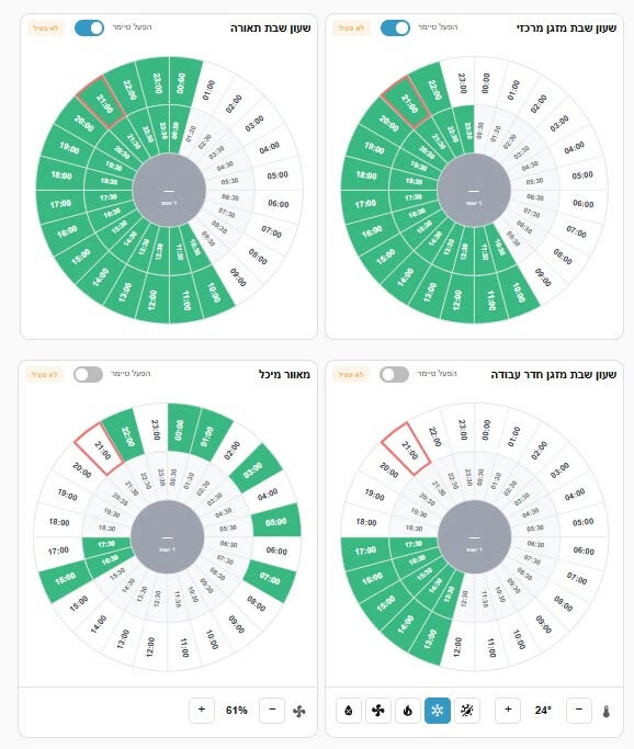

How it works
The day is divided into 48 slots:
  • Outer ring — full hours
  • Inner ring — half hours
Tap the slots you want active.
When the current slot is active and the optional conditions are met, Timer 24H turns the selected entities on.
When the slot becomes inactive, it turns them off.
Schedule changes are saved automatically.

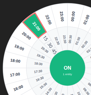

thank you so much for your module—I really like it. Would you consider making it possible to select intervals as short as every 15 minutes?
best regards
Thanks for the suggestion! However, implementing it this way would make the segments way too small and practically impossible to tap reliably, especially on mobile. That said, I do see the value in it, so I’ll try to think of a more elegant solution to handle this without hurting usability.

(de)select on tap, show smaller timespans on long press
v1.3.0 is out (stable).
What’s new
  • 15-minute and 30-minute views, selectable from the card editor or timer Configure
  • 15-minute mode: tap an hour to select it, then tap a quarter (:00 / :15 / :30 / :45)
  • Tapping the outer ring fills the whole hour; turning a quarter off affects only that cube
  • 30-minute mode stays the classic two-ring view
  • Hover shows the exact slot time
  • The Add Card picker now shows a clock preview
Upgrade: HACS → Timer 24H → Redownload → v1.3.0 → restart HA → Ctrl+Shift+R
Release notes: Release v1.3.0 · davidss20/home-assistant-24h-timer-integration · GitHub
@lorbi — 15-minute intervals are in this release. Switch the card to “15 minutes”.
